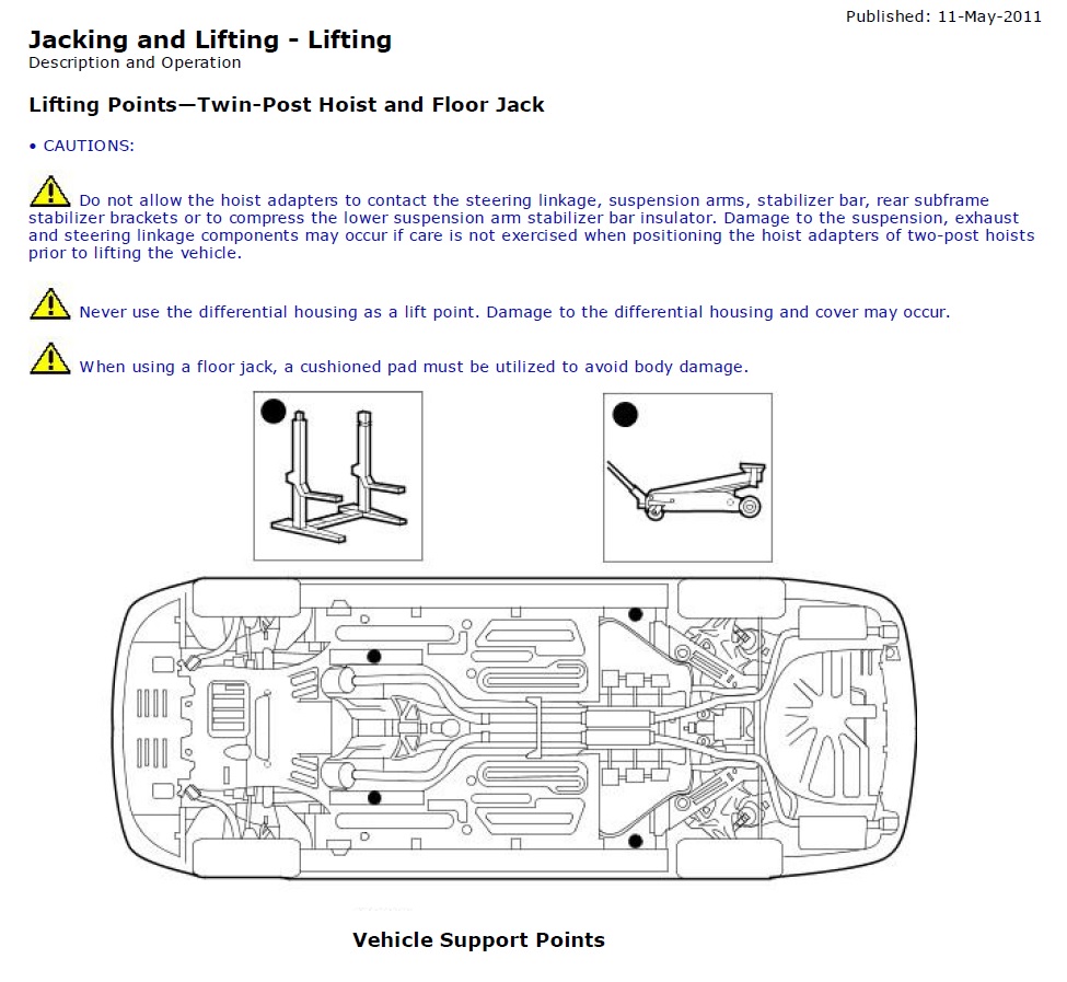

I can't see the attachment either.
Here's the 2011 Workshop Manual section:

Note this is exactly the same as the S Type. The entire underneath is identical.
Thanks GGG - That is it. I was posting from home and do not have a good pdf program there....

+1 same as S-Type

You have fallen for the old trick of confusing the axle stand points with the jacking points.
Which of course is not helped by the confusing terminology from JLR in both the Owners Handbook and the Workshop Manual!
The "jacking points" shown in the diagram are not the jacking points as such, they are the axle stand points.
And believe me, those front inboard axle stand points are correct, I used them dozens of times on my old 2010 XFS and 2010 XFR, and they are outside the plastic undertray.
The jacking points are the pinch weld spots, on the edge of the chassis rails about 3 cm inboard, designed for use with the factory scissor jack which has a slot in the head which fits around the pinch weld.
On some XFs but not all those points are indicated by small triangular indents on the bottom edges of the side sills.
On my XFR the front two pinch welds eventually bent under a bit after one too many times of using a trolley jack on them, so I made a pair of slotted rubber "pucks" to use on the heads of the trolley jacks, lots of posts around here about those pucks which can be found on eBay etc.
You should never use the scissor jack if you can use a trolley jack instead, the scissor jack is too prone to collapse, bend or break (been there done that!) and is meant only for emergency roadside use.
