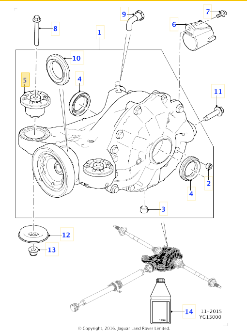

From what I can tell, this points to worn rear differential bushings (especially the front/nose bushing) allowing the diff to rotate under load. I Checked two Bushings they seem ok I could not see any cracks

Dealership wants $37.00 each for the differential mount (#5) haha! I wonder why so cheap?
