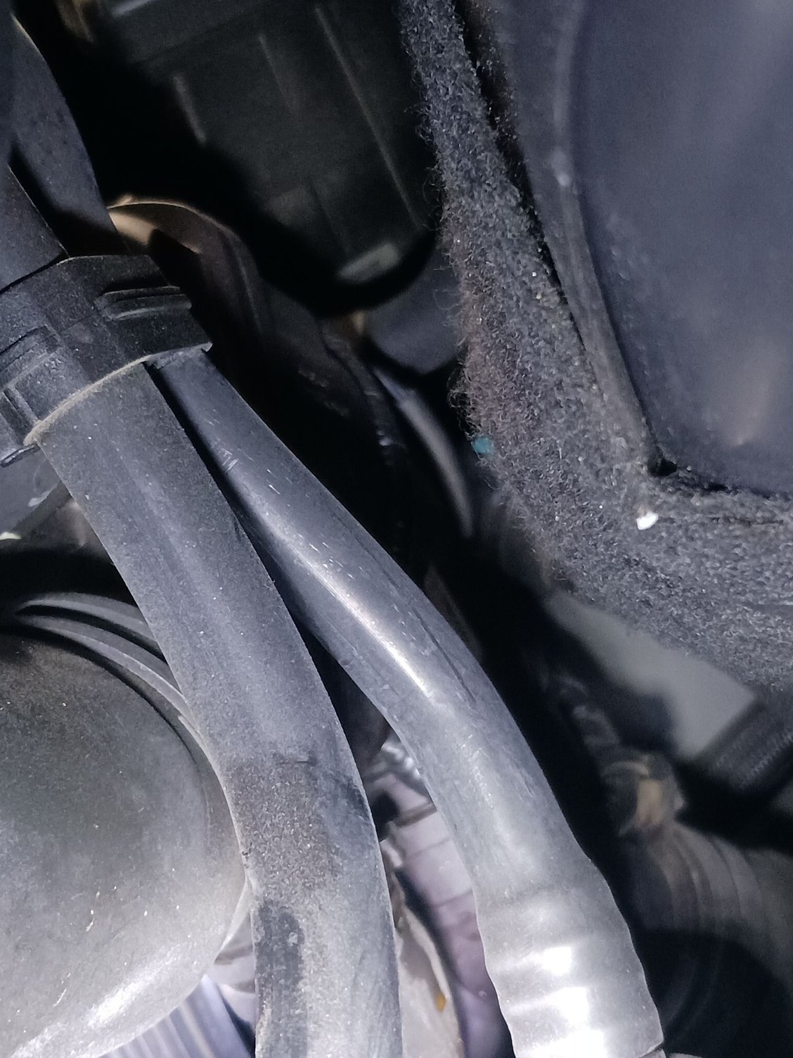

I just caught the leak. Expansion tank was at the cold low line. 2nd time in a week. I usually drive 10 - 20 miles a day. I'm wondering what this is that's dripping? EDIT: Seems to be a small, short hose coming out of the thermostat housing.

Where is that in relation to the engine bay? Looks like it's near the firewall so could be the lines running to the heater core?
Edit, I see from your other thread there are additional photos. That looks like the thermostat housing. These are easily replaced and available in aluminum versions in the aftermarket. Ensure all the electric plugs and fixings are the same as your OEM piece.

I think you are right! Question is, is it the housing pipe outlet or the hose clamp? The hose is the one for the small-diameter outlet on the left side of the housing, or there is a crack where the two halves of the housing join.

It turns out the issue is a cracked thermostat housing. Total price quoted is under $700.00 including parts and 3-hours for labor. I understand the housing was revised in 2023. Hopefully I'll get the new part.
