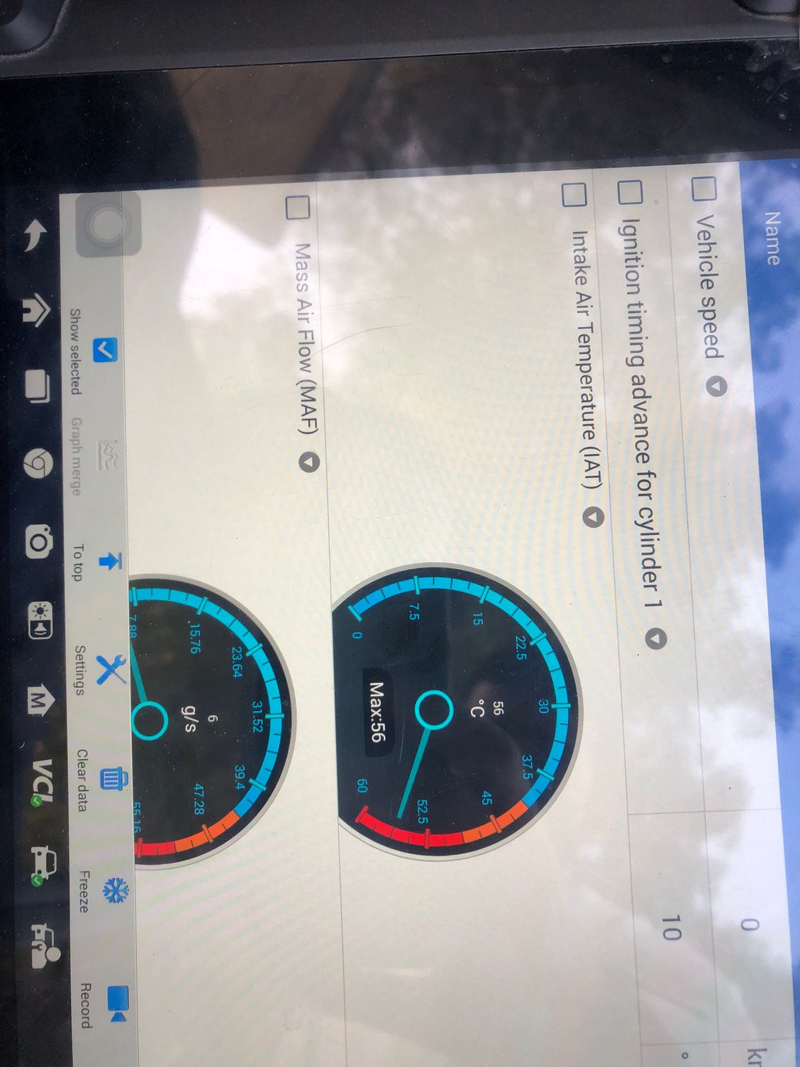

Additionally, I have cleaned the maf sensors with a MAF sensor cleaner, cleaned the catalytic converter, and used STP’s gold bottle for full system cleanup. All to no effect.
Again, there are no errors on the car, no fault codes on the device, and all the readings seem to be normal. The only exception is probably the Ambient Air Temperature reading and the Intake Air Temperature (IAT) reading which seem to be too high judged by the gauge coloring scheme on the device (Photos attached).

You have some model of diagnostic equipment. Do you have the ability to record real-time data? Maybe you could duplicate the problem while "recording" on your device.

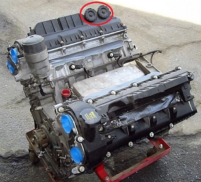

It is worth noting that I just noticed oil level drops midway between service intervals by 1 liter. This is the second time in a row this happens. Also the engine shakes roughly when I opened the oil cap when idling. No oil spills on the cap nor strong suction preventing the opening.
given all the above, Could it be that I have bad PCV valves?

You could replace the PVC diaphragms? They are not expensive and easy to install once you get to them!

As for the oil cap, I took it off and put it back in one second or so — the moment I noticed the engine shaking.
As for the PCVs, I just ordered them and should receive them in a day or two. Decided to get them replaced regardless as dropped oil level and engine hesitation point towards them.
As for the EGR, someone here suggested them. I am not sure on their location either!
I will do the PCVs and will let you know!
