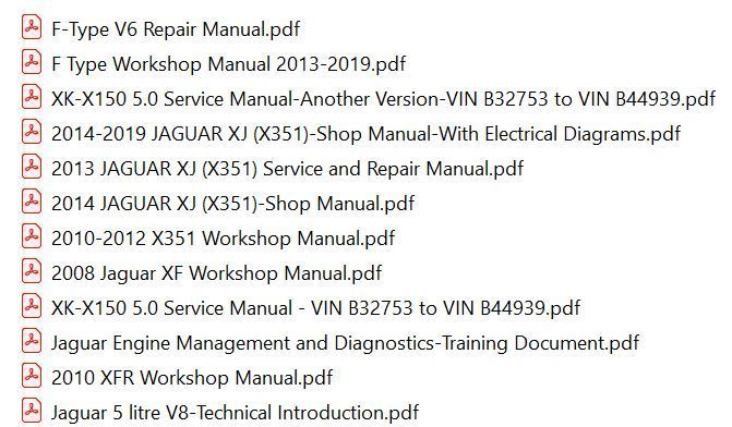

OK let's see if I can help?
Here is the list of manuals I am trying to let folks get.
These are uploaded and can be downloaded using this link.
Jaguar Manuals
It is big at 1.6 GB or so. Sad thing is since this is a free site they will only stay valid for 24 hours. So start downloading!

WOW this is awesome!!!!
