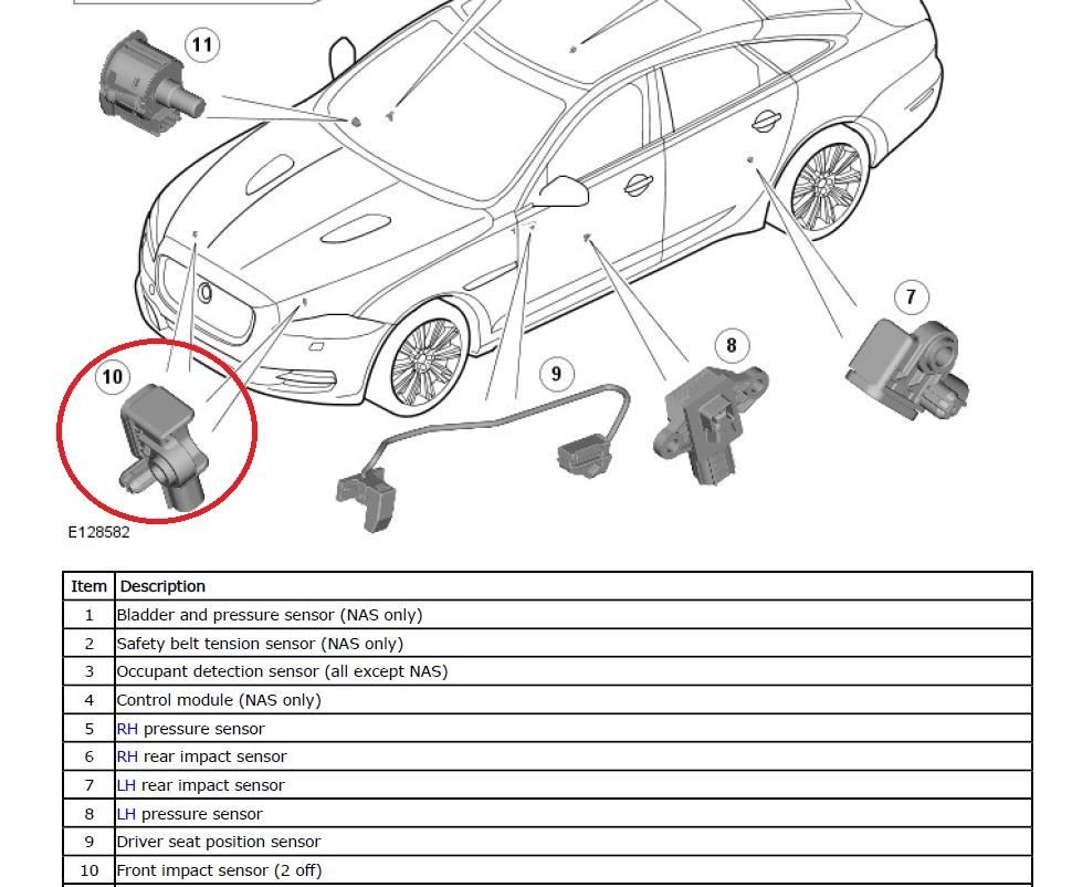

Here is the location of the 2 sensors from JPART.
The part number as always depends on the last 6 digits of your VIN.

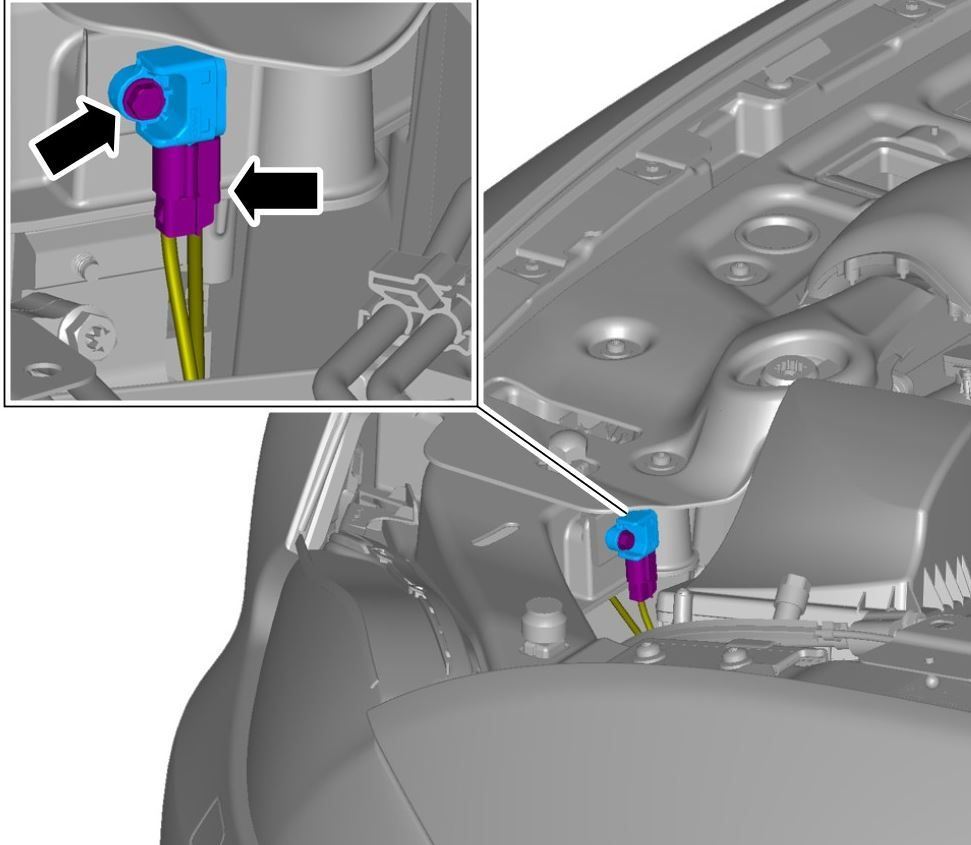

I found a diagram and it looks like they are easy to get to. It's right under the plastic shield above the radiator.
Post back with the cost of the sensor and if that was the problem. But it points directly to the sensor so I would start by replacing it.
They don't go bad very often and I would look for a used one.
Here is a $20 sensor on EBay.
Front Crash Sensor

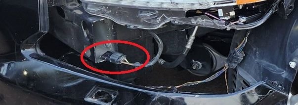

Also, the plug sitting on the front bumper is not the one for the impact sensor- I believe it is for the parking sensors on the bumper (which appear to be working correctly).

I agree the wires did not connect to the parking sensors- they travelled through the front pumper to the passenger side of the car.

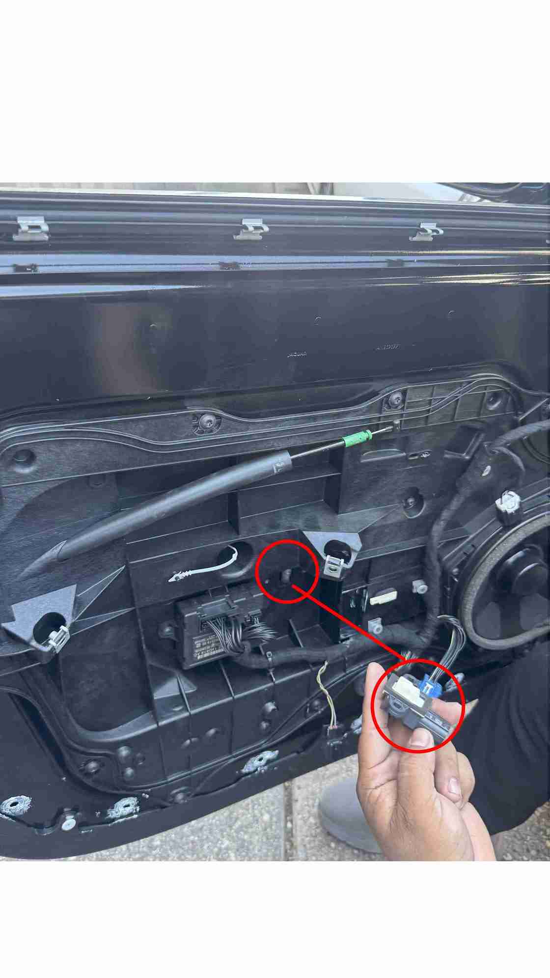

I took it back to the body shop and they switched the left and right pressure sensors as discussed above. Even though I tested the left sensor and it showed resistance, apparently, the swap resulted in changing the fault to the right side- confirming the sensor had failed.
Since you guys asked for what it looks like:
If you look immediately to the right of the door control wiring box, you will see a small cut out hole in the frame. This is where the sensor is placed (the white mart)
