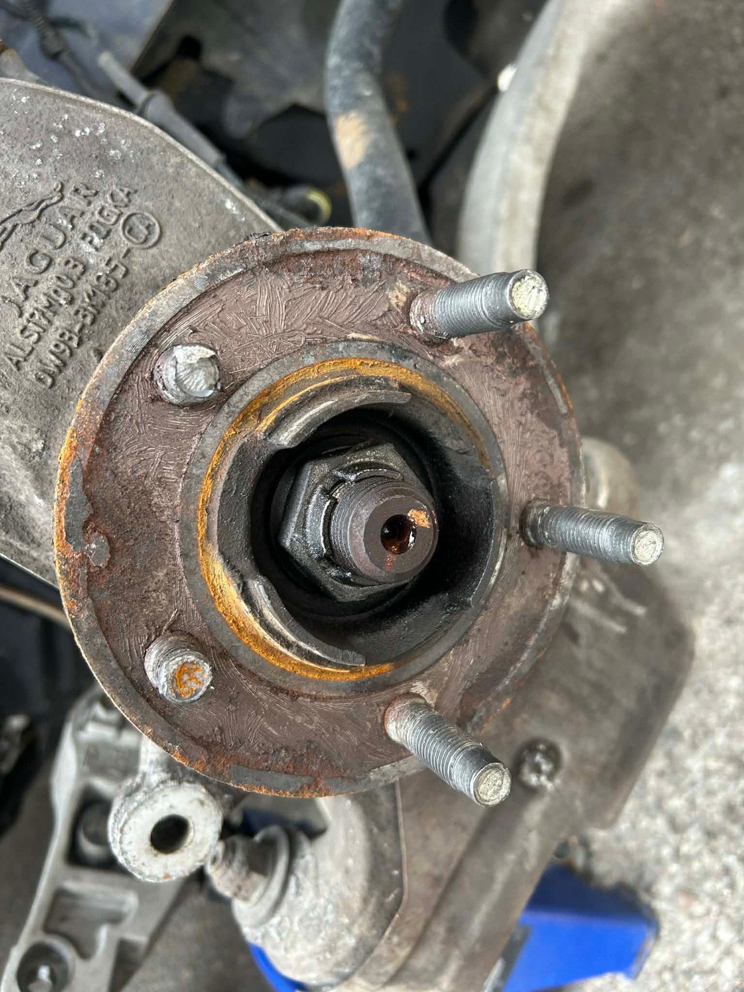

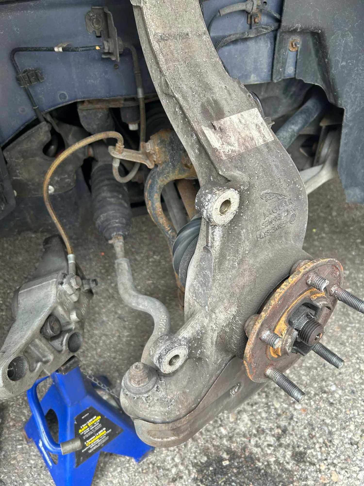

I recently had two lug studs shear off while mounting and tightening a wheel. Given the failure, I’ve decided it’s safest to replace the entire set on that hub to prevent further issues.

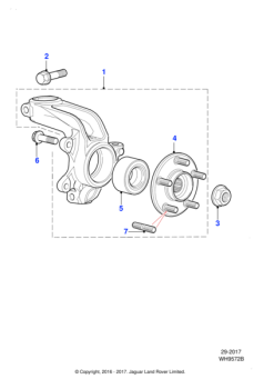

Great timing as this was just figured out by another forum member. It seems JLR has stopped listing the wheel studs separately a long time ago. They only sell the entire hub. BUT Wombat looked and way back in the X-Type era JLR did sell them separately!

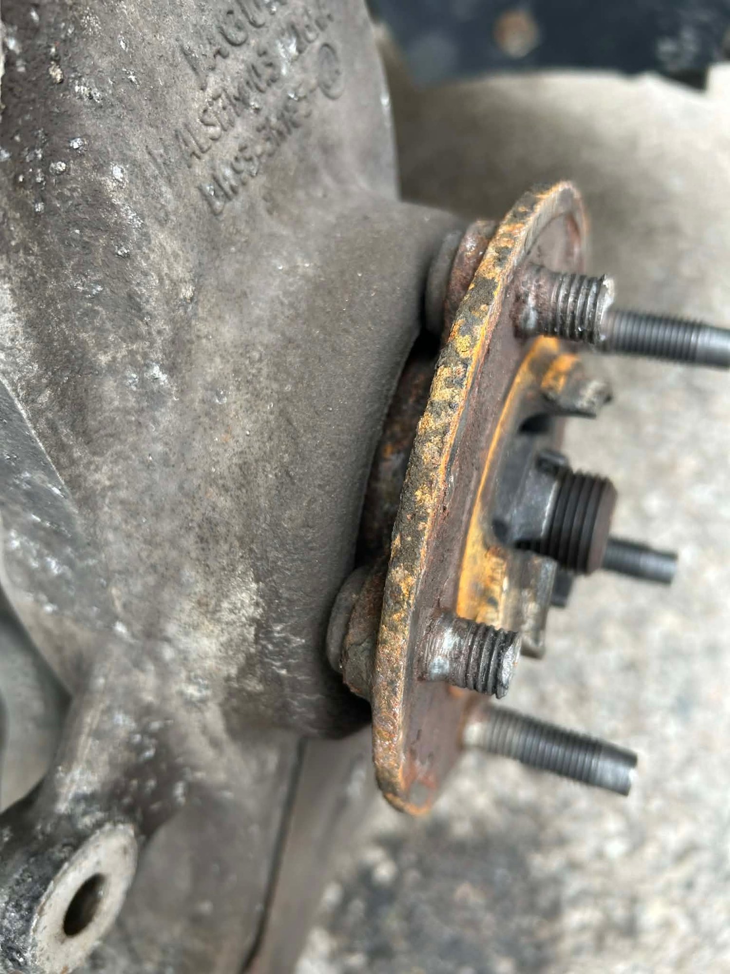

There is no way to remove the studs without taking off the hub first. The rust is so severe that the studs look like they're welded on. At this point, it's probably better to just replace the entire hub.

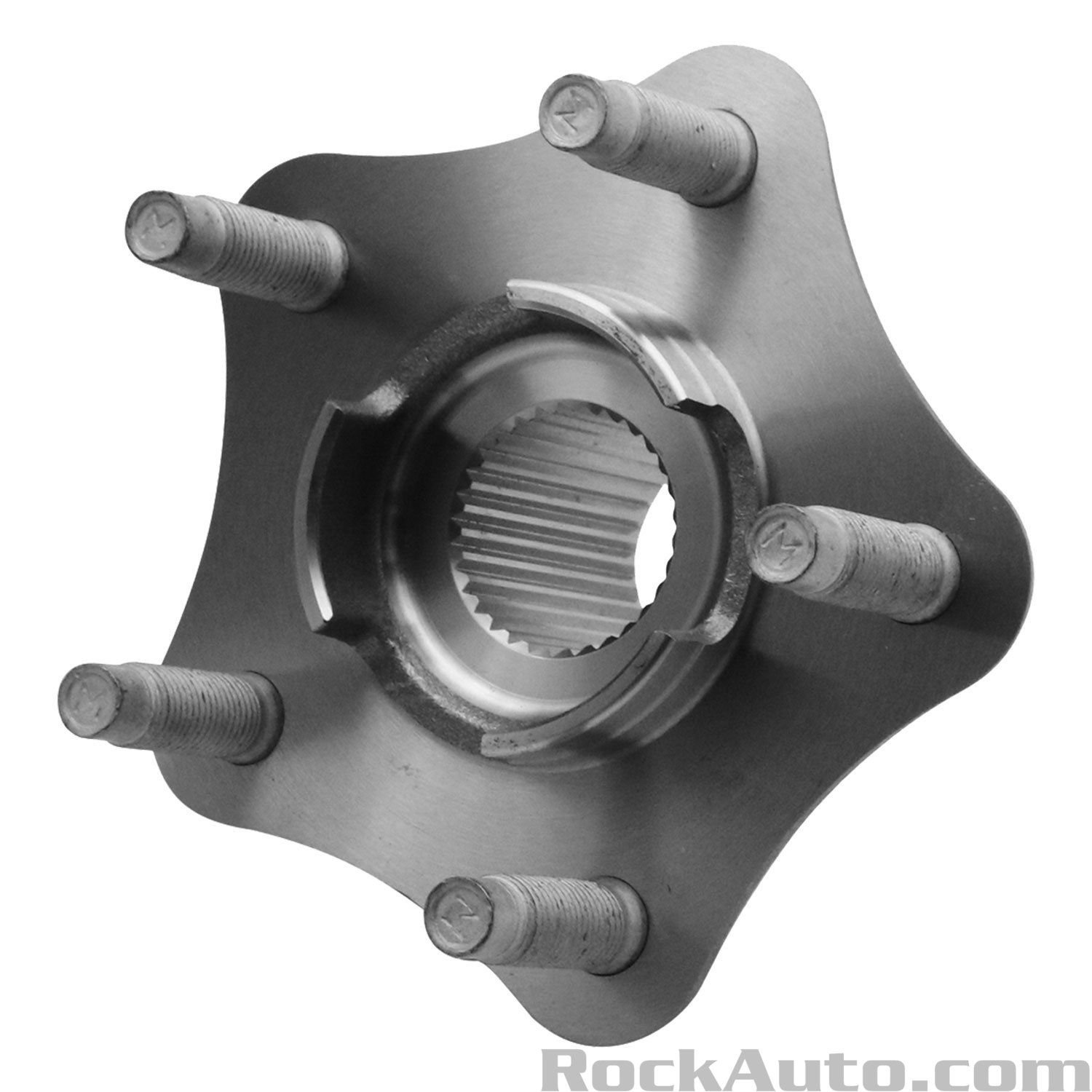

There is one available on rock auto websute it says its for the rear looks exactly the same as the front
