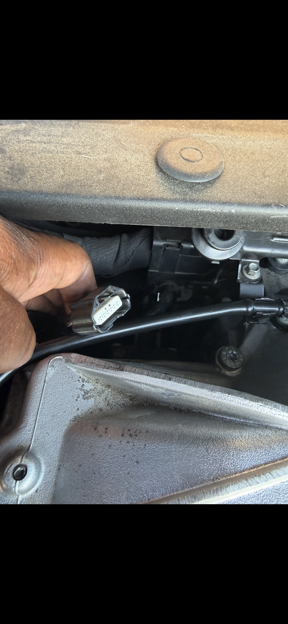

Good afternoon, everyone. I hope that I am in the right place. ( 2016 XJL 3.0L V6 Supercharged.) Recently I replaced all the cheap plastic parts that were causing coolant leaks. We removed the supercharger as well. The vehicle sat for a long period of time for various reasons. We are now ready to get it back on the road, however we are unable to identify what this attachment goes to. It's located to the left behind the supercharger. We would also like to know how to gain access to the trunk with a dead battery. Thank you for your help.

That connector looks like its for the knock sensor loom.

I think GT40 is right on, looks like the knock sensor connector in that location.

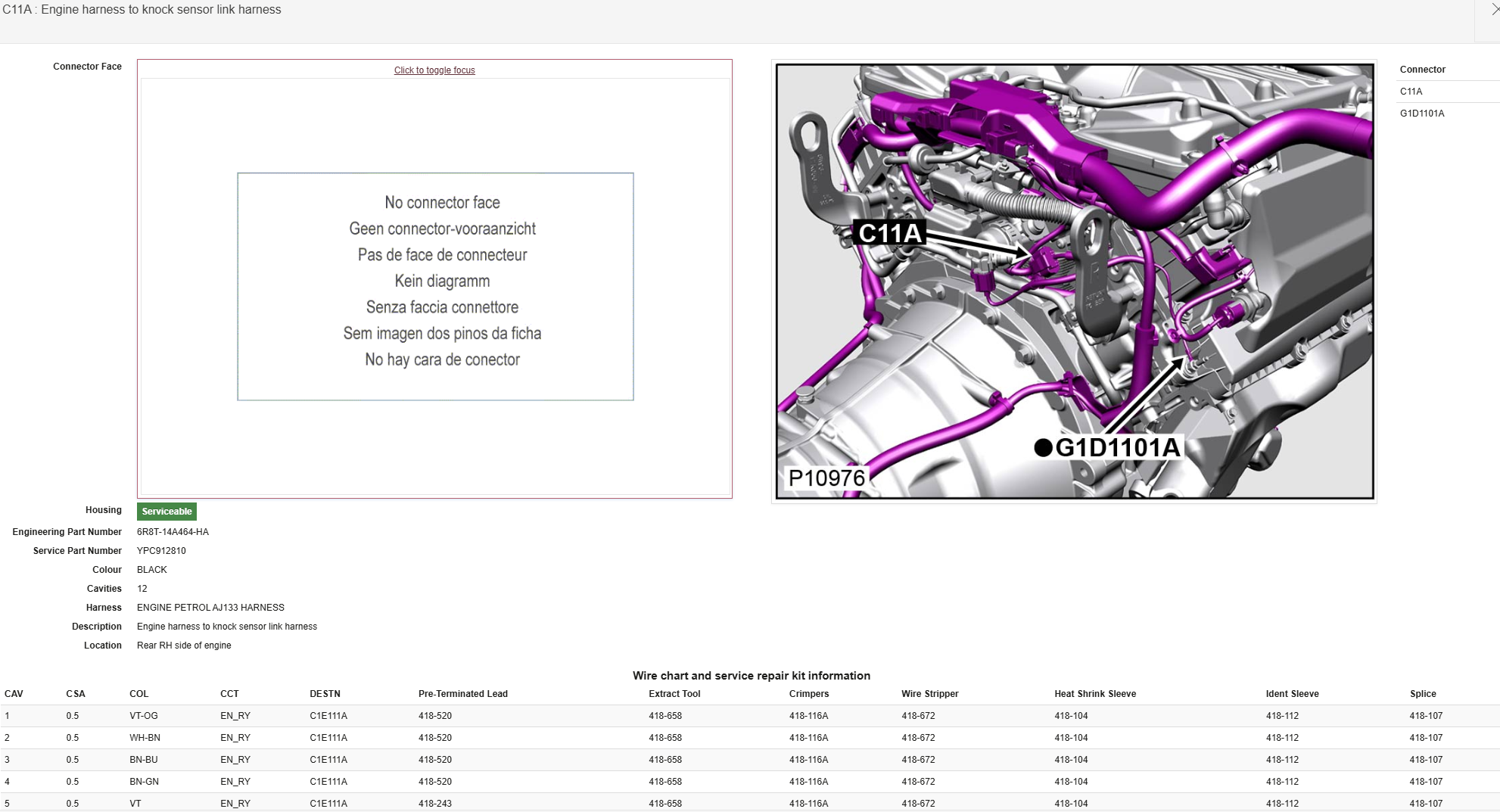

What software/ program is that? Seems useful.

Topix, the workshop manual.
