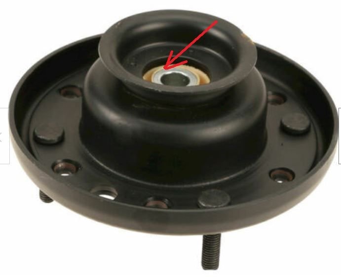

Here is the mount and the red arrow points to what goes bad. Sometimes you can see that the inner bushing is off-center but other times it's not. So visual is NOT a good indicator! The car I changed them on looked perfect at the top of the strut but the mounts 100% fixed his dash noise. I really did not think those two things could be connected but they sure are! Note the mount shown is in the upside down position.
Parts are up to you but I favor factory if possible.

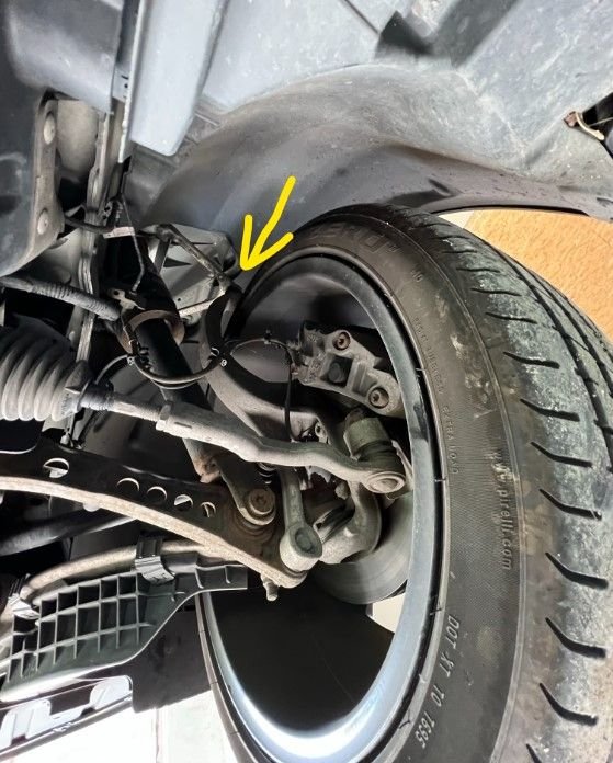

You mean this "A" arm?

The top A arm stud nut needs to be removed (The one in your picture) and the spindle supported because it will want to flop around. I zip tie or wire it up using the hole the top ball joint stud goes into.
