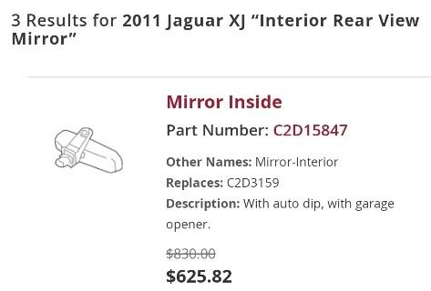

The OP wants to add the Homelink rear view mirror to his base model 2011 XJ 3.0 that doesn't have it. I question if it's worth the cost to do so. He hasn't replied to my question about the total cost of the conversion, including parts (the new mirror) and labor (installation and programming), but it's going to be expensive. It's a lot to spend when you already have the hand-held remote.
The mirror lists for $830 in the USA. The OP is in Italy and I have no idea what it costs there.
