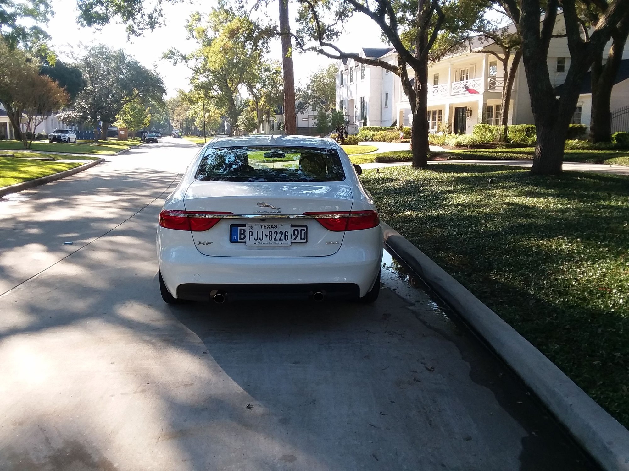

Here's a picture of my XF with a Euro plate.
