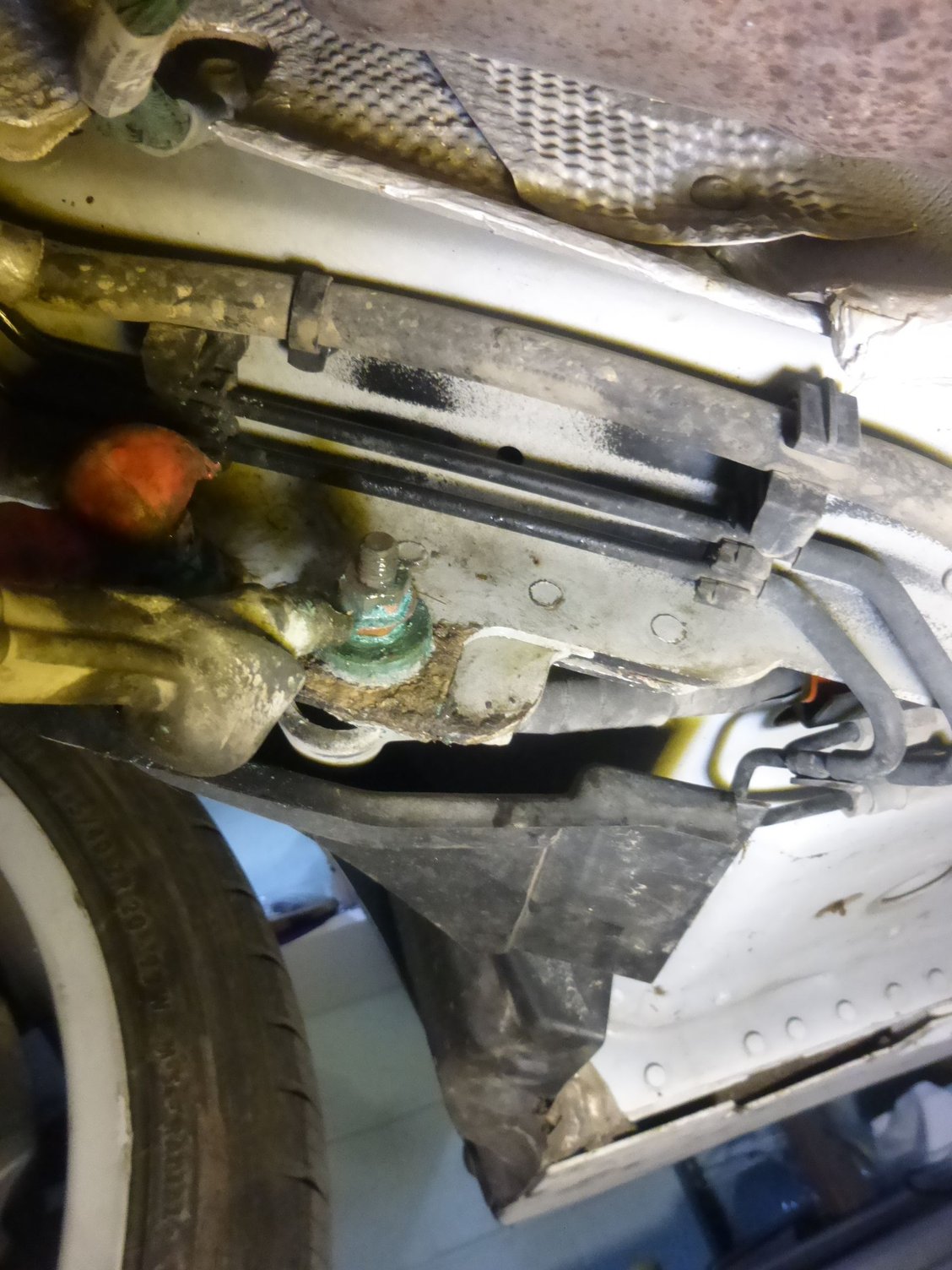

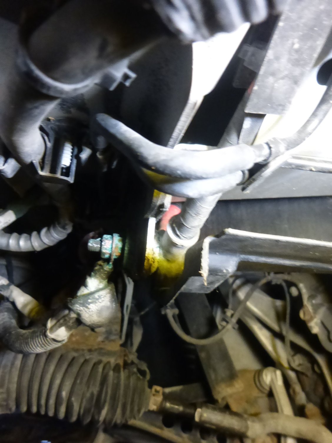

I think it would be still worth the effort to get power back to the battery by connecting to the power wire coming down the RHS of the car . Below are 2 pictures showing the power to the starter motor on my 2014 XJL 5.0. You can do it without removing the inner fender as there is a flexible rubber cover over the outer stud connector.
power connector looking from behind
power connector looking from left
I removed all the corrosion from this connector as part of my winter program

Thanks for the follow up and photos. That was the kind of info I was hoping for. I have had to do this on both my wife's Navigator and my son's F-350. On those, the battery wire went straight to the starter, so had to remove the under car shields partially. This is just a junction block? Thanks, again.

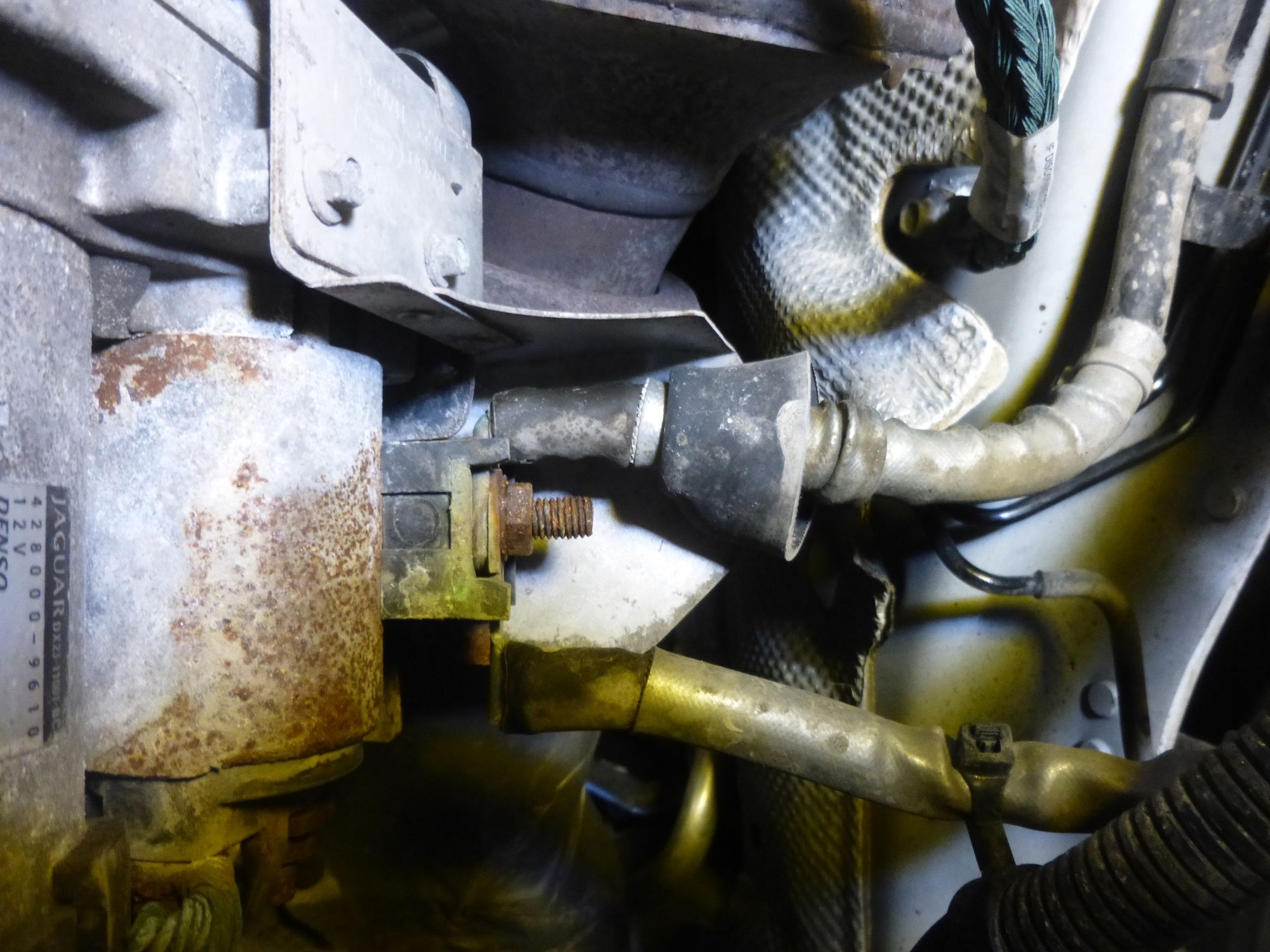

It is and it passes the current through the aluminum frame and on to the starter motor.
This is where it connects to the starter
