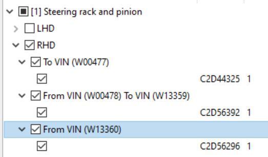

Does your car have electric steering? I think they went to that at the end. Looks like from VIN V90865 on are electric. So check your VIN. I do see there were some further part number changes in that VIN range too.
Use the list above to get the right part number. Be sure to check all part numbers against your car's VIN on any factory JLR web site to make sure it is the right one.
If not a mechanical problem it could be the rack. If it is and you have the electric rack it's not repairable and will need to be replaced. This will be expensive!
Is the car under warranty? I hope it still is.
Part C2D56392 is not available and the price is listed as 3000 GBP! It's a shame they went to electric. Way too expensive,numb steering and not repairable only replace the entire rack. JLR should have kept the better/cheaper hydraulic version. Part C2D44325 has been superseded by C2D56392 so that is of no help either.

Now something I am noticing is you have the RH drive box checked. Being in the States I have a LH drive car. Wonder if that changes things for availability?
