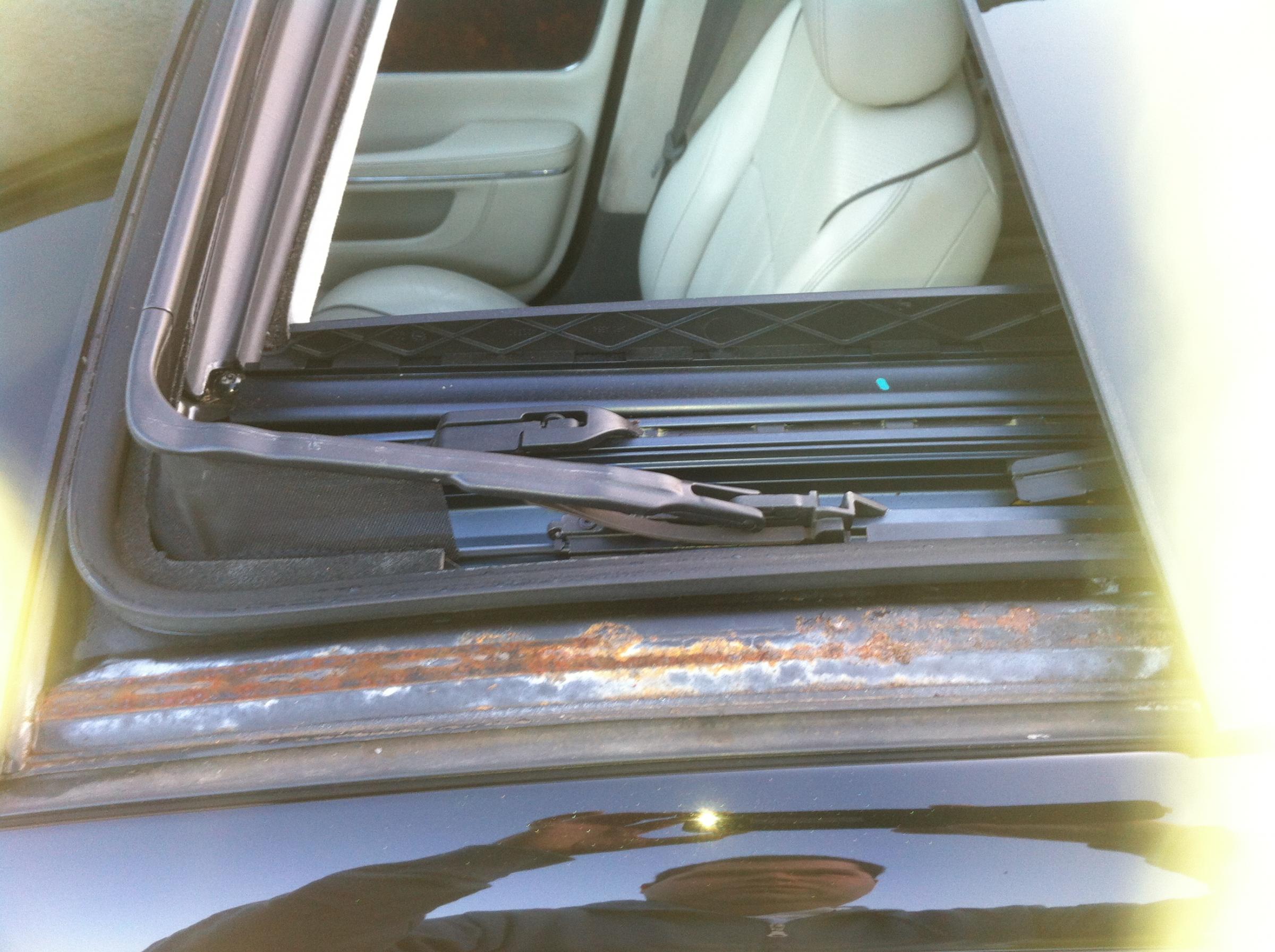

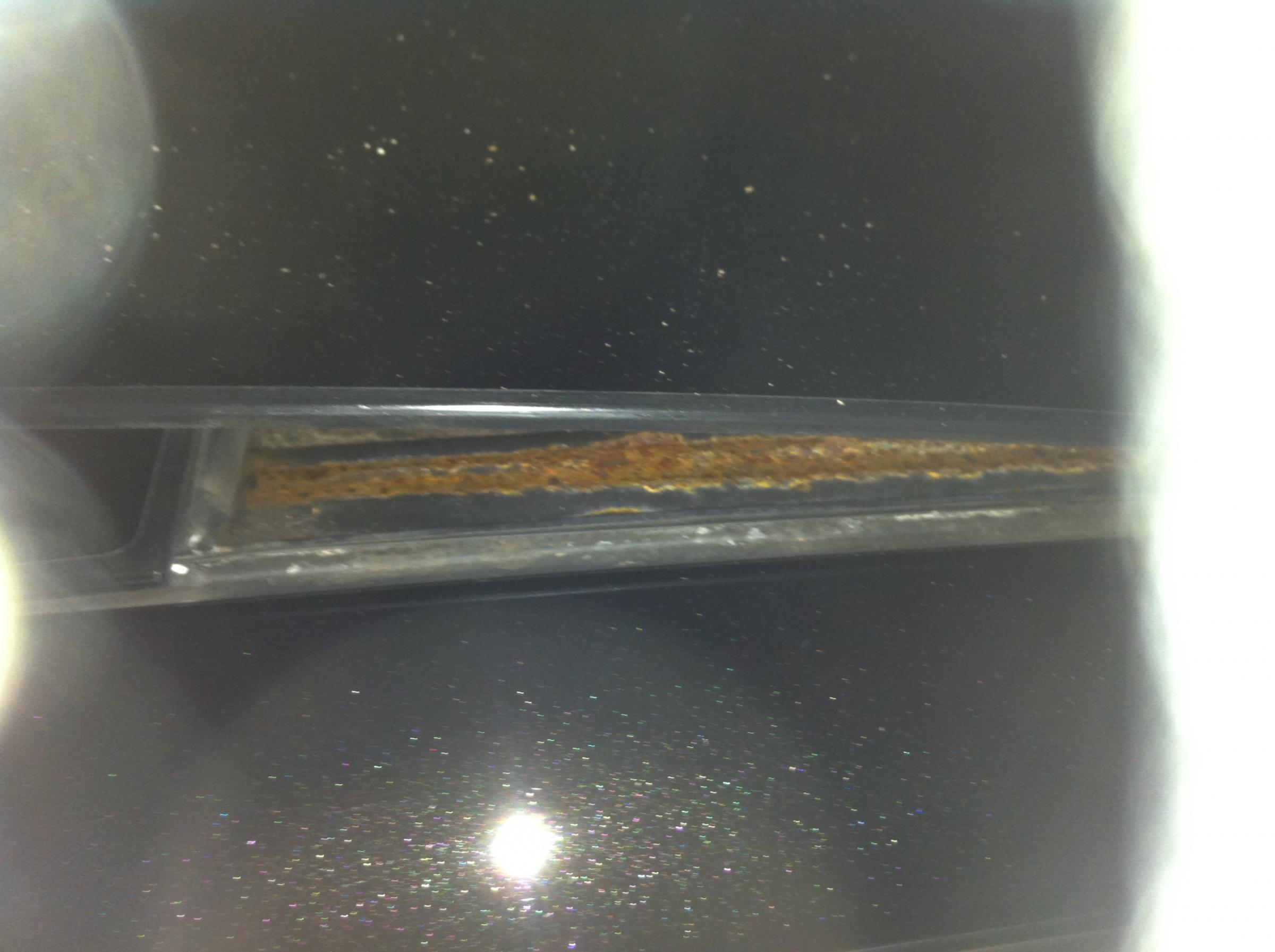

Hay folks,
I have that roof popping noise and after getting it fixed (not), I decided to have a look at what it looks like on the inside when open. I give things a jiggle to see if I could figure out what was making the noise, but no noise. To my surprise however I saw all this rust where the glass sits.
Do any of you have this rust where the sunroof glass sits?
Attached Thumbnails Sunroof Rust.-img_0372.jpg   Sunroof Rust.-img_0381.jpg   Sunroof Rust.-img_0383.jpg   Sunroof Rust.-img_0366.jpg

I didn't think I did, until i cleaned these areas on my '11 XJL. Then noticed a few small (perhaps 1 mm diameter) blisters, which when I scraped them off showed what appeared to be rust underneath. Perhaps this is the beginning condition of what you have. I put touch-up paint on them.

Good luck to you, and please keep us informed. This corrosion shouldn't be taking place, and is totally unacceptable.

Are these cars parked outside? I am a little surprised at the amount of rust!

I think my car has spent most of it's life north of England (Yorkshire area), then 9 months in Scotland, Edinburgh. (last owner) and now me (again Scotland) but I've garage it in any wet and now cold weather. I think you're right though it must have spent most of it's days out in all weathers before I got her for there to be so much rust.

I should think one could test for leakage into this area by running water over the sunroof, or checking these areas after coming out of a pressurized car wash.
Of course, this assumes previous owners didn't leave the sunroof cracked open to the ventilation position and/or didn't close it fully when showers occurred.
After having the sunroof fully opened, to close it one must activate the close button twice, once to bring the glass to an almost closed but still ventilating position, a second time to close the glass to a fully tight and sealed position. Previous owners may have thought they had fully closed the sunroof, but in reality left it partially open.
Another possibility is their was leaf or pine needle debris atop the outer gasket that is supposed to seal against the sunroof interior, thus allowing leakage.
I didn't detect any drainage openings adjacent to the areas of concern, so perhaps any leakage or condensation hasn't any way to drain out.
Condensation, is also a possibility, especially on a car left outside where it is subject to hot sun during the day, and then cool or frosty nights, or even snow accumulations. These radical temperature changes could definitely cause "sweating' condensation on the subject interior surface and adjacent areas, and, without ventilation, such moisture would remain trapped, promoting corrosion.
Normally, after exiting a pressurized car wash, I open all doors, the boot lid, and bonnet to dry all water leakage in the luggage and engine compartments, plus around the doors. From now on I will open the sunroof, to dry these recesses as well.

Well thats it done and they also put some kind of elastic tape on, It's like the same kind elastic rubber protection you get on new devices screens. I guess that should mean the water can't touch the paint work. The white bits are little pockets of traped air, I think a blast from a heat gun should make it stick better.

I've been told on a other forum that it's Mylar tape they've used. He says it's used along the truck bed to protect the paint against rubbing from the weather seal along the bottom of the fibreglass top. It does eventually wear through but takes a few years to get there.

Thanks for remindeing me to have a look. Unfortunately it has started to come back again, so I rang up the body shop guy to have a look at it. He'll see it on next Monday at four pm, he'll take pics and so on for Jaguar to authorized whatever work needs doing to it this time.
Don't pay for any work that they suggest as it's up to them (Jaguar not dealer) to fix it free of charge. If they think it needs new sunroof pod then thats on there head not yours.

I have just checked mine. My car is a 2013 model. It does not have bare metal and appears to have instead plastic or plastic coating in this area.

Mine is going in to have a new sunroof frame fitted, I am pleased to say that the total cost is now been met by Jaguar and the dealership after some arguing and the fact they new I was going to go to court to recoup any costs they wanted to burden me with for what is an inferior component.
One thing I am going to do now that I know of the problem is to open the sunroof and apply a good coat of wax and everytime is goes for a wash I will make sure the roof is opened and the edges are dried off. I may even spray it with silicone spray each time as well for double measures as I dont want the rust to reoccur if they have not altered the spec of it. I will be selling the car or trading it in early next year, so hopefully it will not be a problem to me whilst in my ownership.
