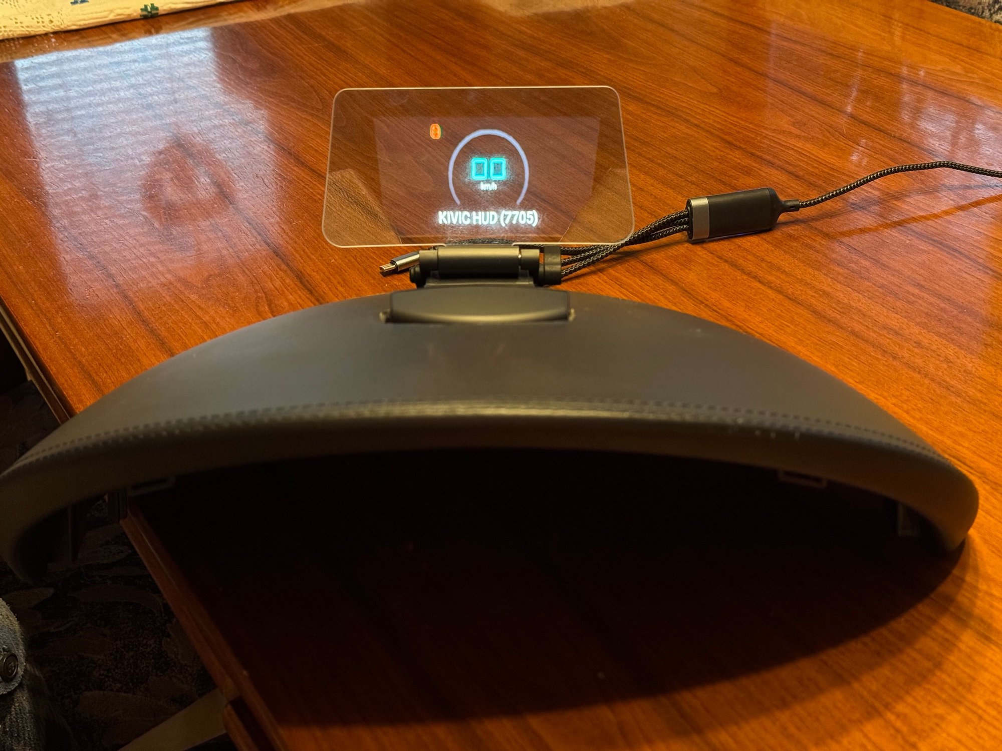

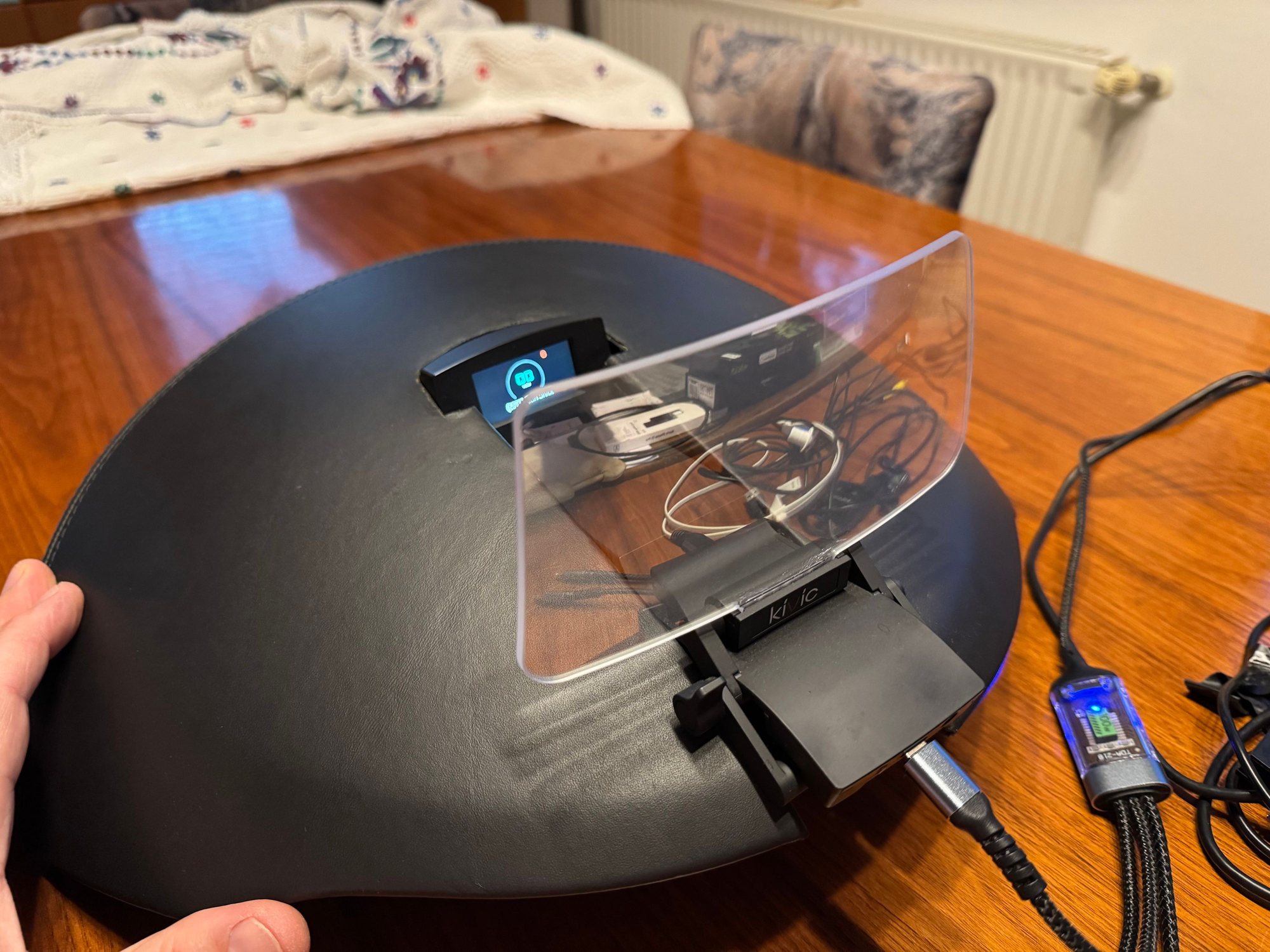

Hi,
I had a try something similar some years ago. It worked for years but unfortunately the support was discontinued for my device (Kivic HUD , if I remember correctly it was Australian) .
as it showed data
as it showed data
background
background
Please let me know if you still use this Pontus HUD. What is your experiences? May be you can post some new pictures wit the new config. And also if you have a link to this manufacturer or seller... of Pontus.
Thanks. Gab
