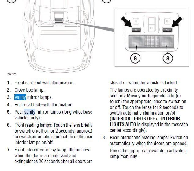

You should have an owners manual?
Here is the page telling you how to turn the interior lights on and off. We do have a free copy in the stickies at the top of the forum?
It would be wise to get a copy.
Here is the page from the owners manual;
Post back if this does not work.
I know your new but batteries are a problem on some XJ's. Locking the car and putting it on a CTEK maintainer if not driven regularly will help a great deal.
I can't explain it but the life of the battery is all over the place? I just changed mine after 10 years! BUT I have seen other cars that need them replaced every couple of years.
Is the current battery the correct AGM H8 battery? Just something to check.
Post a picture of the cable your talking about as it's hard to figure things out using written descriptions.
