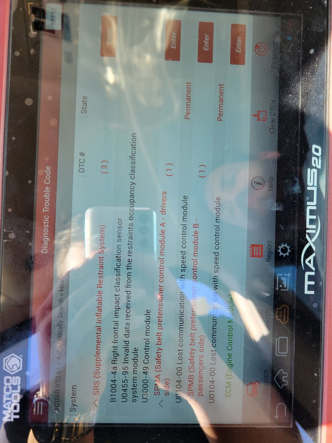

Little update, drove the car around a full day and check engine light came towards the end of the day. Next day tried to start it, and just crank no start. Also the cooling fan comes on right away. I plug up the obd, clear all the codes and it starts right up. What do you guys think? Change the coolant temp sensor? Or something else could be the issue? These are the codes that came up

The X351 Workshop Manuals and Electrical Guides are in a Sticky at the top of this Forum. They can help you interpret the DTCs to pinpoint the problem(s) instead of trial and error guessing.

Can't say as codes should not stop the car from starting?
