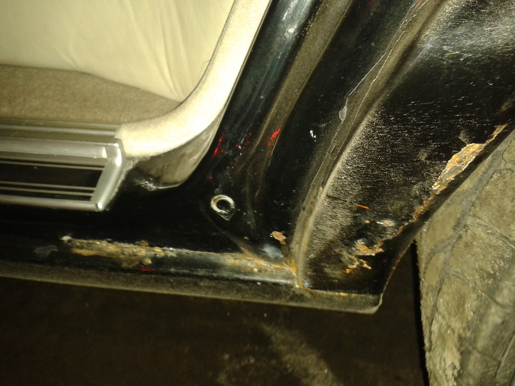

I have been looking for a V12 Daimler for quite a long time, these are very rare in my country. Even if you find one, it will likely be very abused both technically and cosmetically. We have lots of snow in winter and tonns of salty solution are poured onto the roads to melt this snow instead of removing it. That's why if any car like a classic Jaguar is driven in winter time in Russia it will be badly rusted. So my target was to get a car that hadn't been driven much in winter. And in the end of 2014 I found one. Overall the car is quite good. Most of the paint is from the factory, the interior is good as well (in need of a good cleaning and some seat elements need to dyed). The engine and tranny are both good.
But there is still much work. First of all, the rear left wheel arch is badly rusted. Seems like the car had an accident someday and the repair was not done properly . The water had ingressed and the metal rotted from the inside. The rest of the body has no rust at all. Luckily, the shop I use has the donor car, so we cut the needed element from the donor and welded it into my car. You can see this work on the pictures, not painted yet. To be continued...

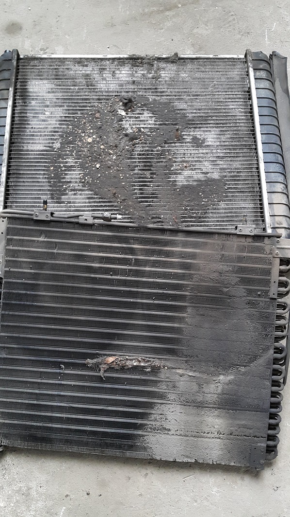

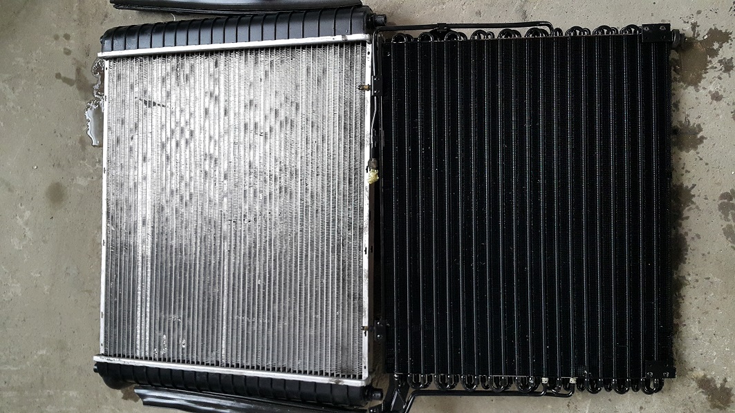

While I was driving the car in the traffic jams I decided to entertain myself by connecting my OBD adaptor with the Torque app. What I noticed was the engine temperature at about 105 degrees Celsius, which was too high considering the cold weather. Also the cooling fan was working almost all the time, which was also the evidence of something being wrong. At the same time, at higher speeds, the temperature was around 90 degrees Celsius, which was fine. Everything was pointing on the clogged radiators. Knowing the importance of keeping the mighty V12 cool, I decided it was a good time to remove the radiators and clean everything up. My thoughts were correct and the radiators were indeed very dirty. You can see the pics of "before" and "after". Now my kitty is ready for the hot summer.

Wow, no kidding.... I've seen radiators clogged up on the inside, but not so much on the outside.

You have done well with the radiator cleaning! Cooling system maintenance is the most important part of keeping the X305 V12 running for a long time to come. Great that you found one still in mostly good condition there. Please keep us updated on your progress.

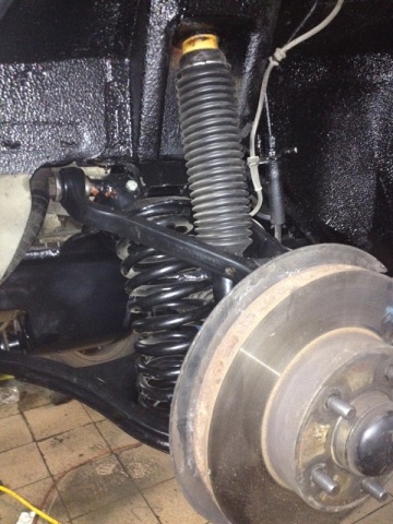

The wisbones and front subframe are powdercoated and ready to be installed (all new rubber parts are in place)

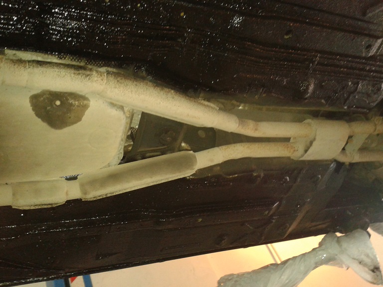

The bottom of the car is being coated with rust protection material right now

The suspension pieces are back together. Yesterday was the alignment job and the first test drive. But something seems to be wrong with the new front springs, the car now sits extremely low, even worse than with the old stock springs. Seems like these new springs are the wrong ones, rated for 6 cylinder car.

That's some nice looking work Alexander. But it might be near impossible to find new V12 springs. You might have to reuse the old ones. They are responsible for the ride height. Perhaps they are still springy enough, despite their age. With all the other components renewed, any difference might be unnoticeable.

Yes, that's a shame these springs are not available anywhere. Today we are going to temporarily reinstall the old ones, until we manage to find the new ones somehow somewhere. This will hopefully enlarge the ride height a bit, but this will not help very much because the old springs are too compressed due to their age.

Well, the car finally sits on the new springs and drives great. Last weekend I decided to test fit the 19 inch Atlas wheels from my XK8 (the XK got the new 20 inch Sepangs). It was pure curiosity as I was skeptical about how these 19 inch rims would fit the X300, but it worked out great in my taste. What's also important is that the ride quality has not suffered, the car drives even better now. The steering became more responsive and accurate, but there is no much harshness added. The next step is to refinish the headliner panel in Alcantara.
