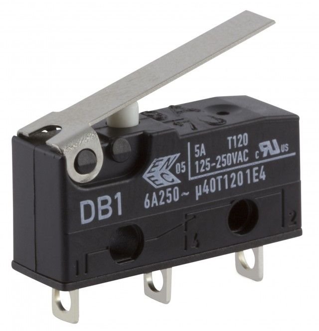

If you have to order the switch there is a throw dimension before the switch makes , this is sometimes hard to find but has a huge effect on adjustment
Some people have put in the reverse functioning switch equivalent , normal open vs. normal close

I was at the salvage yard today looking right at a opened up X300 shift box and the " Not in Park " switch with a short pigtail and connector
I'm sure it works as the car was driving up to the point it got beat up by a 2 trucks in front and back
I'll put a meter on it like I should have while looking at it . That way you will know if it's normal open or normal close if you were to order a new one and you can see the throw length which is how much the red button depresses and not the metal arm to actuate it
