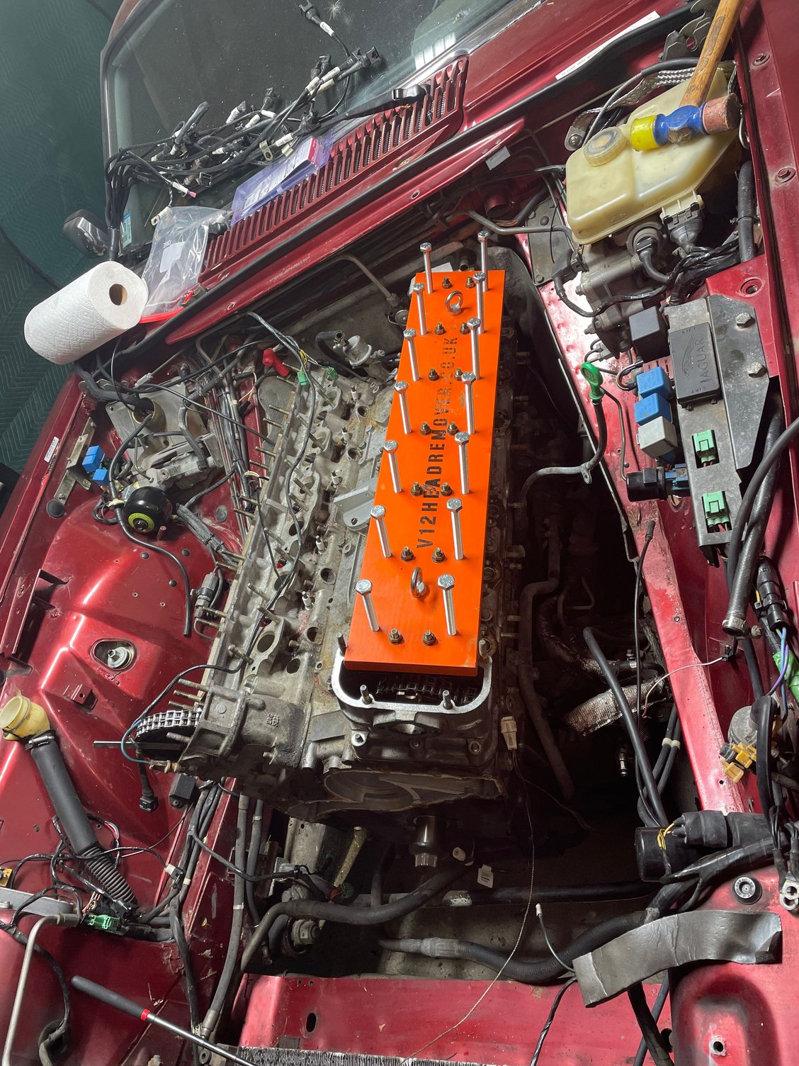

I will absolutely take lots of pictures! But it will be a while. The demoralizing tranny out leak made the XJS broken timing chain look like the easier work. Plus I already bought the parts and that area of the barn is easier to heat. Wish me luck!

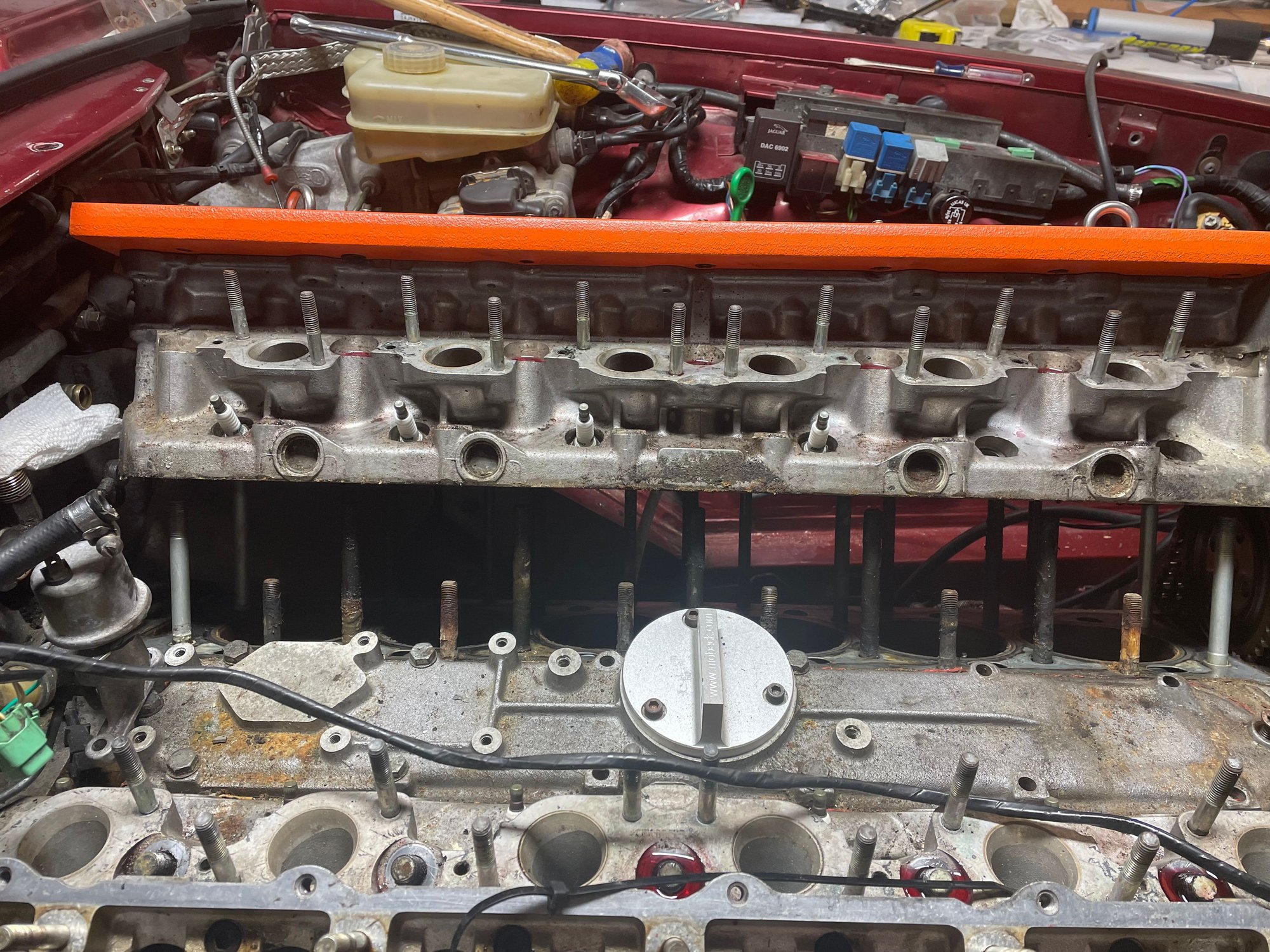

An hour and 20 minutes later it’s off the studs. I’m just too tired to lift it.

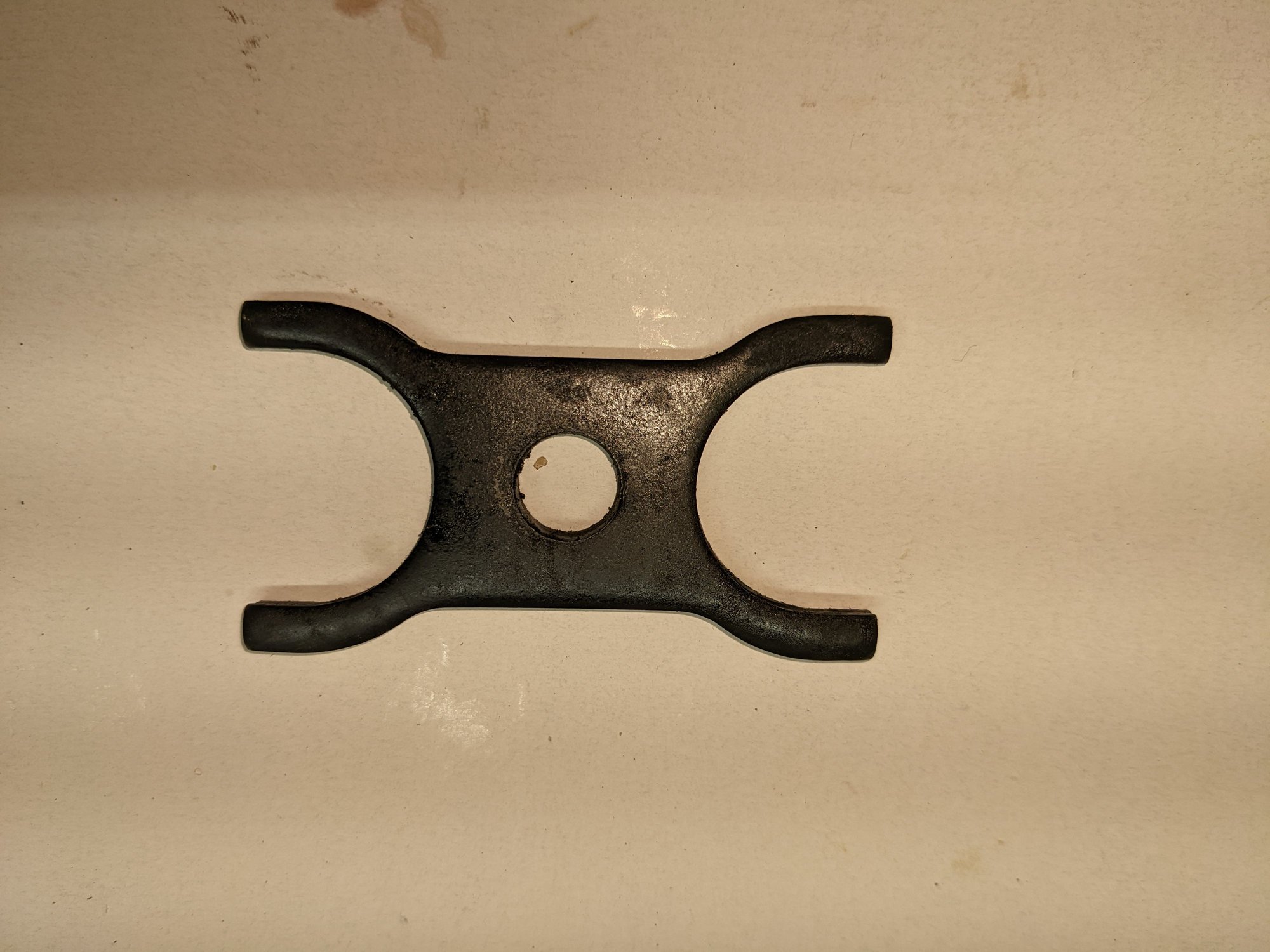

Yes there's two hoses, one in one out. but more importantly they are attached to two aluminum pipes that go into the filter housing.
They are held in place by a single bolt in the middle of this little plate squashing two o rings
If that bolt has come loose and/or an oring has failed that is close to the area of the rear of the engine.
Worth a look, hard to see without the subframe out...
