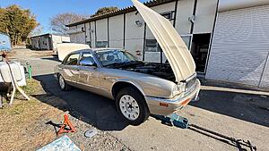

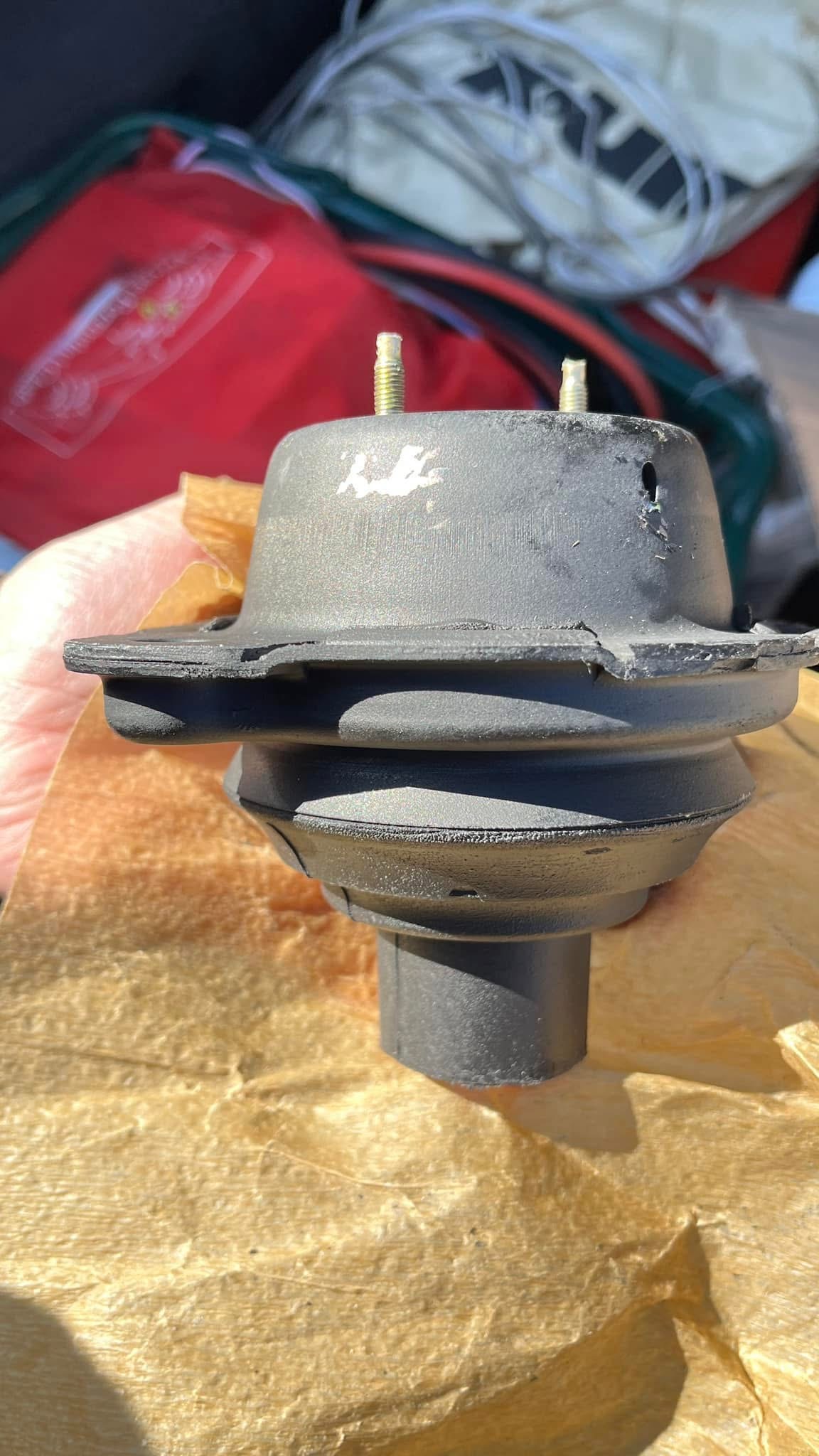

Unhappy Old type engine mounts MMD7500AA fits to later VIN 777507 and up
I learned that the engine mount MMD7500AA (for VIN up to 777506) is compatible with MNA7500AA (for VIN 777507 and up). So I ordered 2 of those and arrived from Jaguar Classic Parts who offered me 20% discount. The outer box of the part had date code of Nov. 2015. It means that the parts were made approx. 10 years ago. In addition to the rubber itself, there is probably oil in the rubber, so it is interesting to see how well a product made 10 years ago would perform as it should, and how long it would last.
Anyway, I could replace engine mounts. My VIN is 795773, but MMD7500AA perfectly fitted, but unfortunately the engine vibration at low engine speeds did not disappear. Although there was a slight reduction in vibration due to the new engine mounts, however, the old engine mounts did not seem to be the cause of the engine vibration, as the vibration continued to occur, I replaced the all spark plugs and all spark plugs were almost evenly burnt.
I am now wondering what to do next. Should I try replacing ignition coils? Any advice would be appreciated. Thank you,

Hello Kenichi san,
Have you also replaced the transmission support bushng? That is a known area that can create vibration.

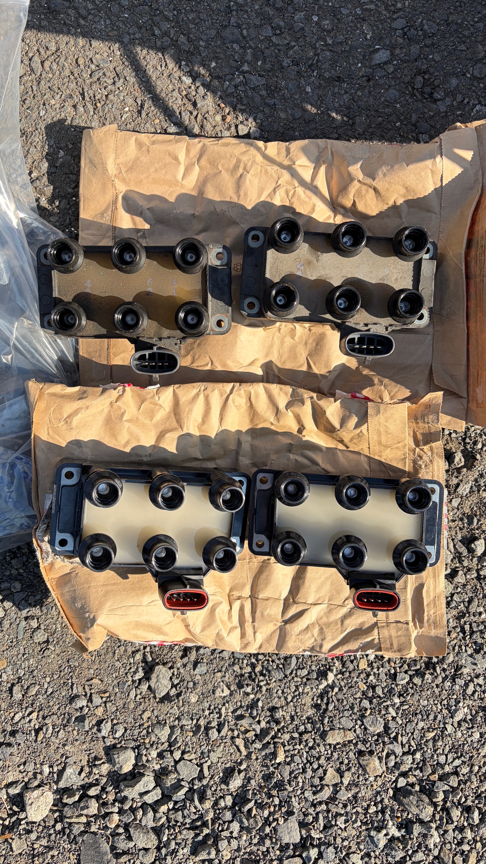

Wires and coils would absolutely be the next stop for me. Didn’t even realize my car was running less than perfect until I replaced them. Denso was the OEM brand. I’m not sure of the cost effectiveness of ordering from USA, but rockauto.com has Denso coils for our cars for $65 each. I think I did NGK wires from $36. Cheap cheap cheap, so do it!

Yes definitely do this before going further on transmission mount etc.

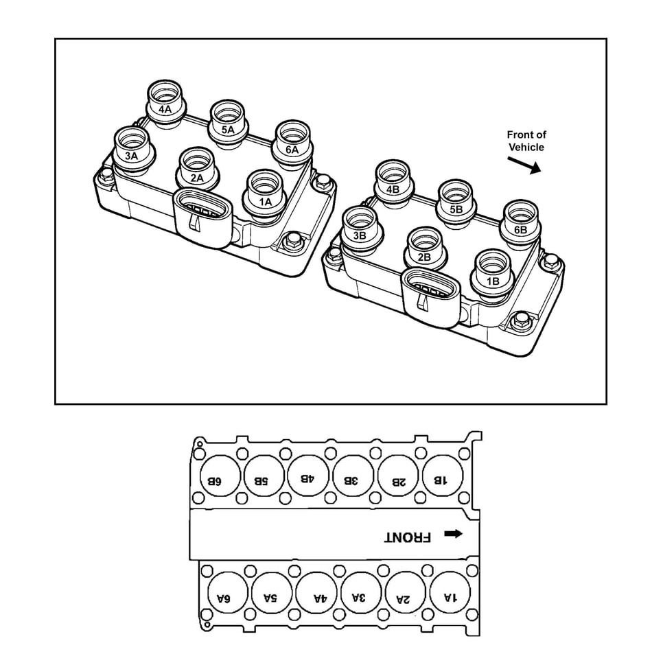

As long as we are talking coils, someone posted this very helpful diagram years ago and it is worth re-sharing.,,

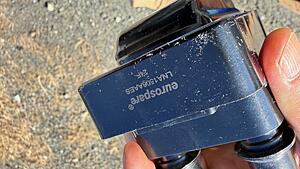

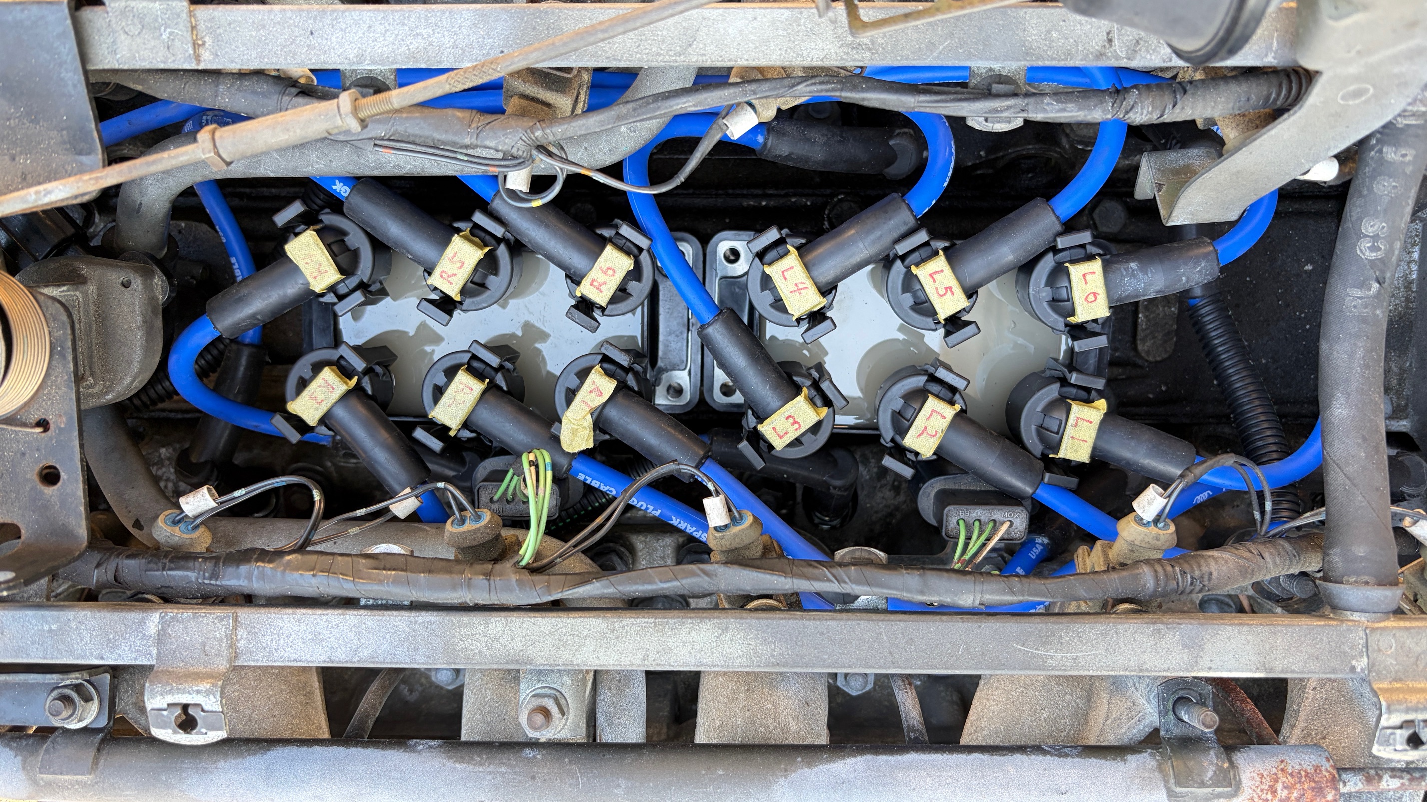

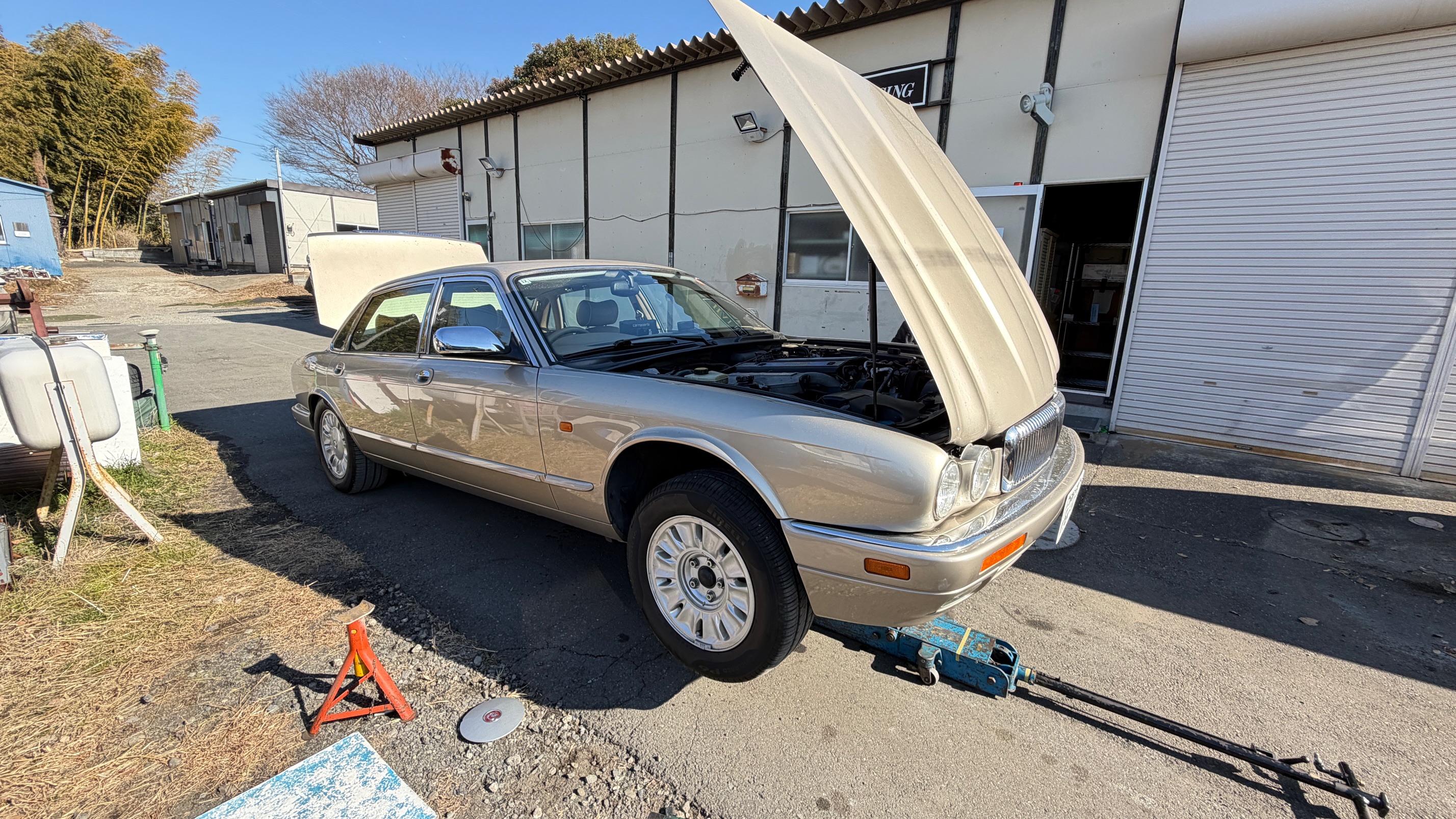

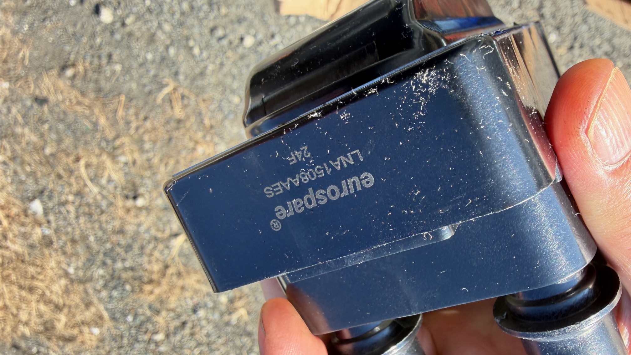

Hello all, it's been quite a while, but I replaced the coils (Eurospare), plugs (NGK), plug coad(NGK) , and rear transmission mount. The result? The vibration hasn't gone away unfortunately. After the warm-up is complete and the RPM stabilizes at 800 RPM in P range, shifting into D range (750 RPM) produces a noticeable vibration and humming sound. Shifting into P/N range brings the engine RPM to 800, and the vibration and sound subside.
Is the transmission support mount featured in this YouTube video the EBC9040 linked here? https://parts.jaguarlandroverclassic.../brand/jaguar/
I'm not sure if this part number is correct either. That's because the Jaguar Classic Parts diagram specifies it for the X300, 6.0 Litre ZF 6-speed automatic transmission. My transmission is a 4-speed GM unit, so the part number might be different. Frankly, I don't recall the X300 V12 ever having a 6-speed transmission option.
I asked Jack at David Manners Group, but they don't have the part in stock, so I haven't replaced it yet. The EBC9040 is also an expensive part like the engine mount, so I'm being cautious. The YouTube video says that if I feel vibration around the center console rid, there's about a 90% chance this bearing mount is the cause. In my car, there's no vibration from the center console rid; it feels like the vibration is originating further forward section.
As I reported before, I replaced a pair of hydraulic engine mount (MMD7500AA) last year. Could it possibly be a faulty engine mount perhaps? I'm at a loss as to where to fix next. Any thought / advice is highly appreciated!
