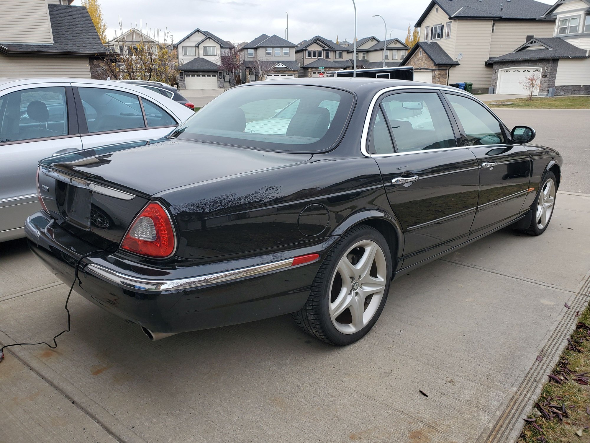

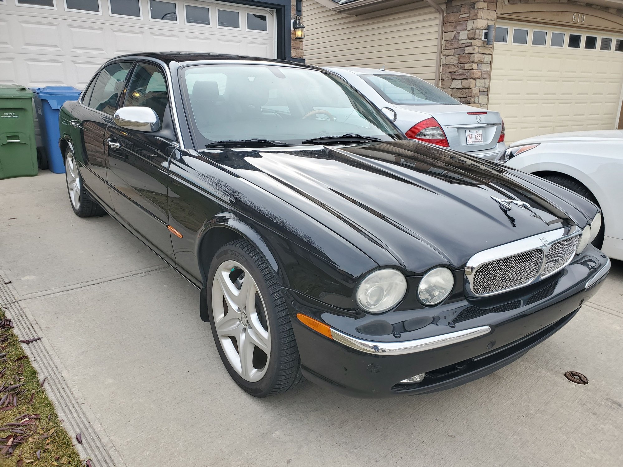

Hello Guys, it's been a while since I posted. Last few months picked up a 05 XJR, 05 E55 AMG, 70 E TYPE FHC.......And today a 05 Jaguar Super V8. 147k MILES (238,000KMS) But with an extensive service history.
It is showing code 0171 and 0174. Something to do with running lean. It's super smooth idle. But will go into Limp mode.
Old owner had 02 sensors replaced. Then gave up! Any ideas what it maybe?
Here are some photos!
It's a project. I only paid $3000 from a friend! An absolute bargain!

Yes educate yourself as that engine has a rubber coolant hose under the SC which will fail and is a tough repair. Check that P/B booster vacuum line as xalty suggested above. It's another pretty much guaranteed failure point.
Good cars and look around the forum as just about all the problems have been solved.
I hate to ask but how is the air suspension? Probably the most expensive problem area.
I see the head lights are cloudy and again that is dead common and not too bad to polish the head lights out.
