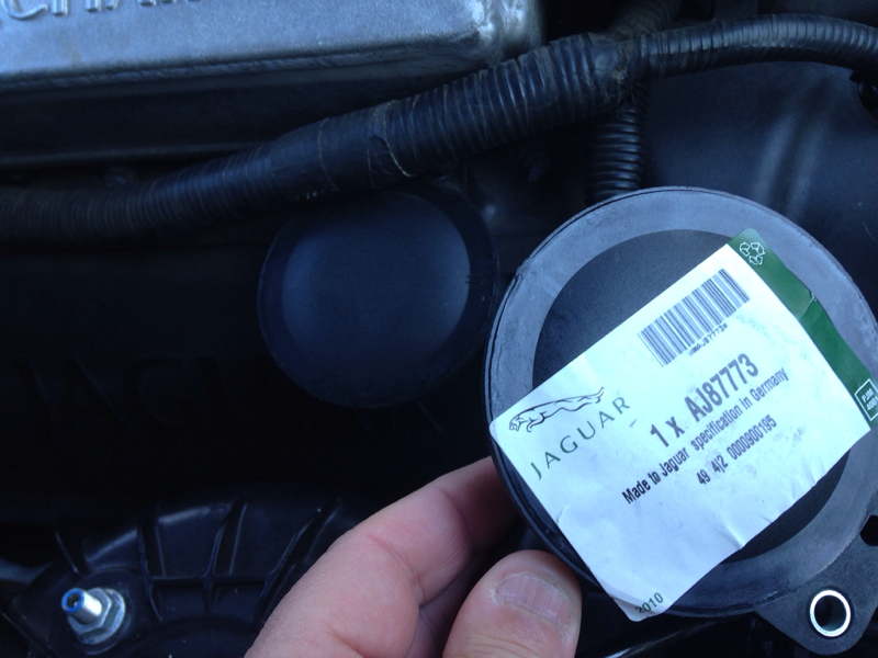

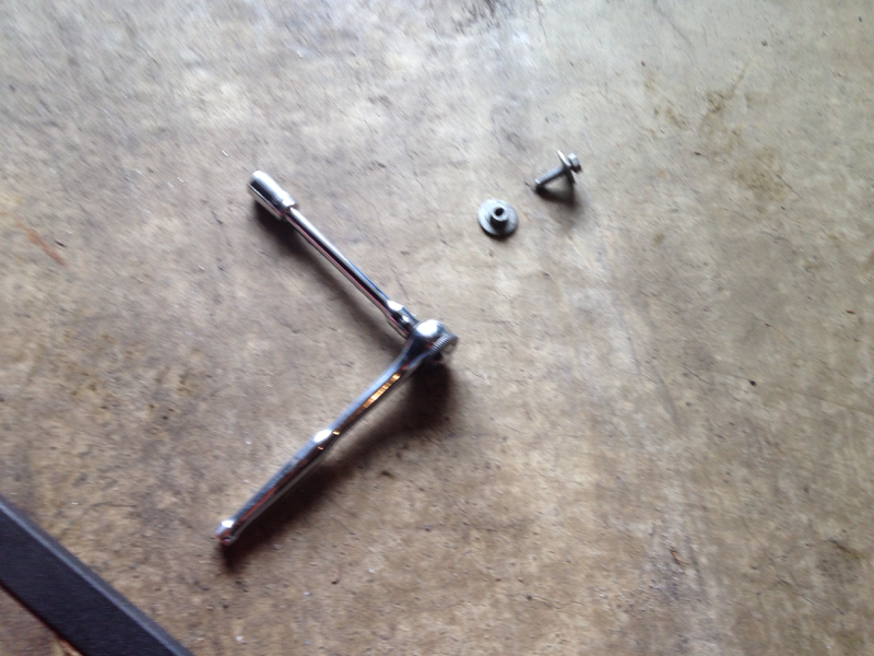

Ok. Had a P0171 Lean Bank 1 Condition. Thanks to the forum members for all the knowledge acquired here. I am posting my experience in the hope that it may help someone else deal with P0171.
First option was to replace the O Rings on the PCV valve and associated hose. This area was scrutinized as these areas seemed to hiss. Anyway O Rings did not fix, so replaced PCV. Here are some pics of this process.
Attached Thumbnails P0171 Code Resolved-image-176601281.jpg   P0171 Code Resolved-image-1123860895.jpg   P0171 Code Resolved-image-1314097742.jpg   P0171 Code Resolved-image-1830628364.jpg   P0171 Code Resolved-image-2716020146.jpg

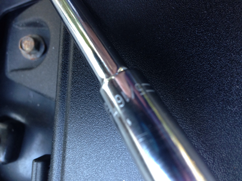

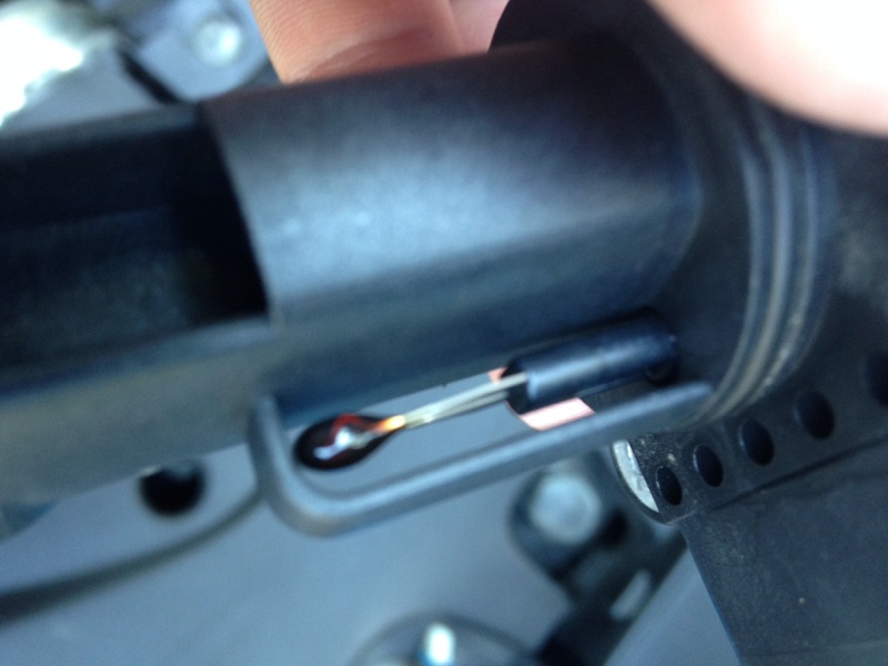

Next up was a MAF cleaning.
This did not change my LTFTs which were around 19, but now I know, the MAF is clean.
On to the next step...
Attached Thumbnails P0171 Code Resolved-image-399655982.jpg   P0171 Code Resolved-image-3266086588.jpg   P0171 Code Resolved-image-4162556545.jpg   P0171 Code Resolved-image-4099291473.jpg

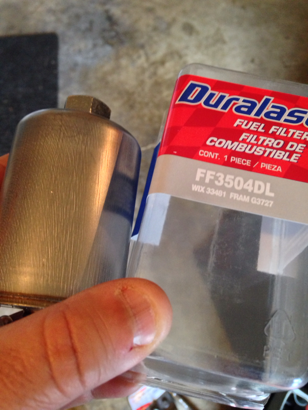

Fuel filter replacement up next. This was straight forward, thanks to the advice in de-pressurizing the system so as to not 'wear' a bunch of gas from the filter exchange process.
Anyway, here are a few pics of the event.
Again, this did not resolve the reoccurring code, but at least the fuel filter is renewed at 83,000 miles...
Attached Thumbnails P0171 Code Resolved-image-1327646886.jpg   P0171 Code Resolved-image-1075968644.jpg   P0171 Code Resolved-image-4129730637.jpg   P0171 Code Resolved-image-1319974459.jpg   P0171 Code Resolved-image-1350051634.jpg

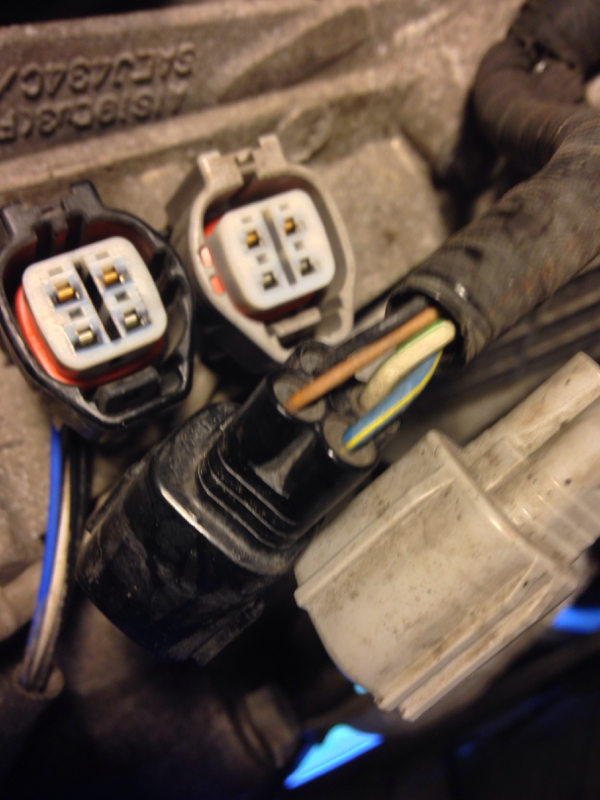

So, on to the 02 sensors... This was interesting. Disconnected electronic connectors and 'poured' a bit of water out of the upstream connector.
Sprayed this with some water dissapater and thought that I had the code taken care of.
No luck, so onward.
Attached Thumbnails P0171 Code Resolved-image-3942457788.jpg   P0171 Code Resolved-image-409063753.jpg   P0171 Code Resolved-image-3813370951.jpg

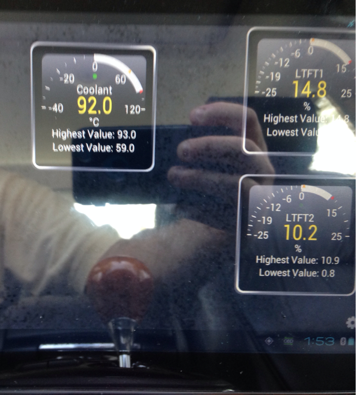

So, in the meantime I ordered an elm327 bluetooth obd2 device online. An installed the Torque app on android tablet. This way, I could view real time data and did not have to borrow code reader from coworker.
Here's a shot of LTFTs in action...note this shows post-repair LTFTS reading 14.8.

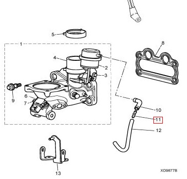

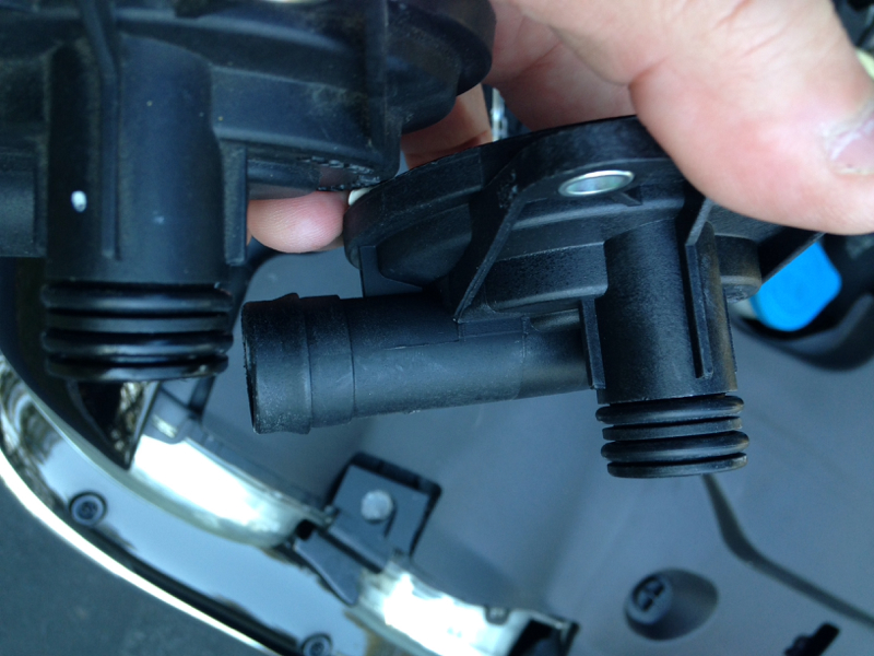

So, took this in for some professional help, who hooked it up to the smoke machine and Voila!, a thin, 'birthday candle width' of smoke rising from the rear (left) passenger side of the engine bay. Apparently, a plastic 'hose joiner' had cracked.
Here is a pic of it in two parts as it snapped fully during removal. And NAPA had the replacement...
Attached Thumbnails P0171 Code Resolved-image-3452401464.jpg   P0171 Code Resolved-image-3653461242.jpg   P0171 Code Resolved-image-3038084312.jpg

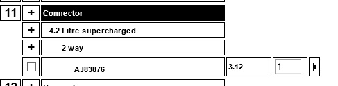

Thanks for the step by step. Do you know what hose it was with the bad "T"?
Old May 7, 2014 | 07:00 PM
magmedia's Avatar
Joined: Mar 2009
Posts: 901
Likes: 258
From: Eastern, MD
I recall that this image was recently shared on the forum, believe this was it.
Thanks-
mag
Attached Thumbnails P0171 Code Resolved-connector.jpg   P0171 Code Resolved-connector2.jpg

Very nice step by step description! I believe the fuel filter connections utilize two o-rings (one on each side). Did you re-use the old ones or did you fit new ones? I do not think aftermarket fuel filters of the canister type come with the requisite o-rings....
Reuse existing orings....
Thanks- Mag

From: Eastern, MD
Originally Posted by JagV8
What are LTFTs now?
Prior to repair, LTFTs bank 1 was around 19. Last check 14.
Thanks-
Mag
14 is still high. I'd want nearer 0, maybe within 5. I'd be worried 14 was allowing a lesser fault to persist, possibly doing damage.
Both banks?
Does it drop at 2500-ish rpm (hot engine, parked)?
