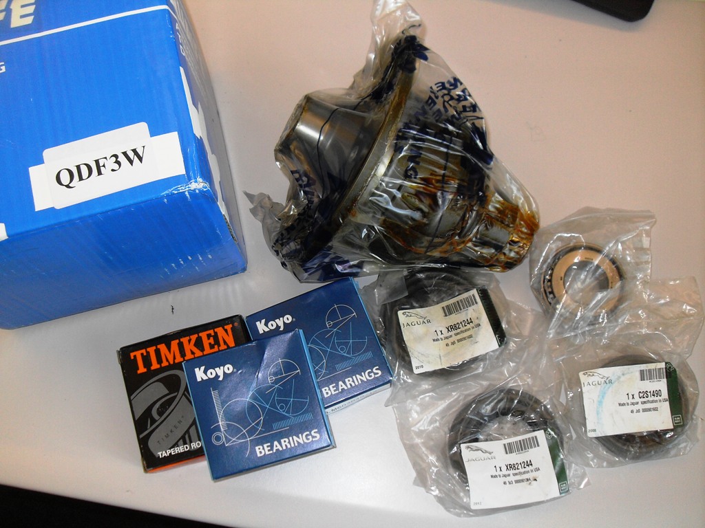

It depends on which diff you have. Is it the Ford/Visteon 8" or the GKN diff?
You can see the difference in this thread, where the Ford/Visteon unit was removed and replaced with the GKN. https://www.jaguarforums.com/forum/x...97/#post960840
Seals are available as spares for the 8" but not for the GKN as far as I know...
Seals and bearings for the Ford/Visteon 8" are shown in this thread https://www.jaguarforums.com/forum/x...96/#post983905
Some pictures of the seals here
