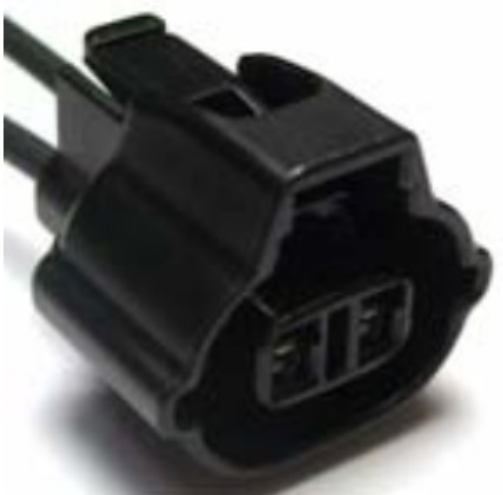

Originally Posted by DonsXJ8
Just had my two tire TB plug fall apart last night. I was driving home and got the STD. engine systems fault and when I was poking around it decided to unplug the connectors to the TB and the two wire connector crumbled. So in my search for a replacement connector I stumbled upon this thread and found it useful. I also found another possible option other than the plug Lagonia ended up using. I'm going to order some and thought other may have some interest.
SouthBay Fuel Injectors
Did this 2-wire connector replacement work? It looks like a better potential fit with the design shown in your link above.
It does not fit. The side grooves are not centered and the top groove is not wide enough on Denso connector. Pictures are from X-Type TB, but I assume is the same as X350.
Side grooves not centered on denso connector.
Top groove not wide enough on Denso connector.
Side grooves not centered and top groove not wide enough on Denso connector.
I continue to search for a replacement connector, there just has to be one out there.

Talking I found the connector!
The connector is available for sale here: Jaguar x Type Throttle Motor 2 Way Electrical Connector | eBay . It fits and works perfectly .
Get them while they last!
