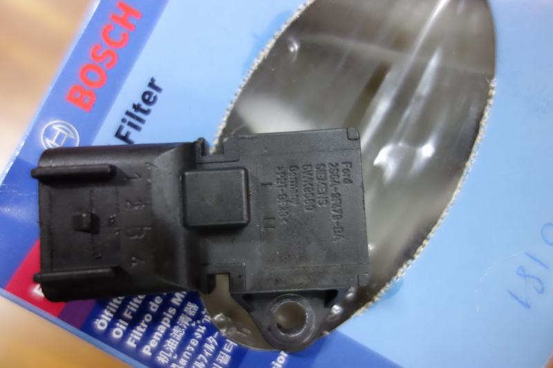

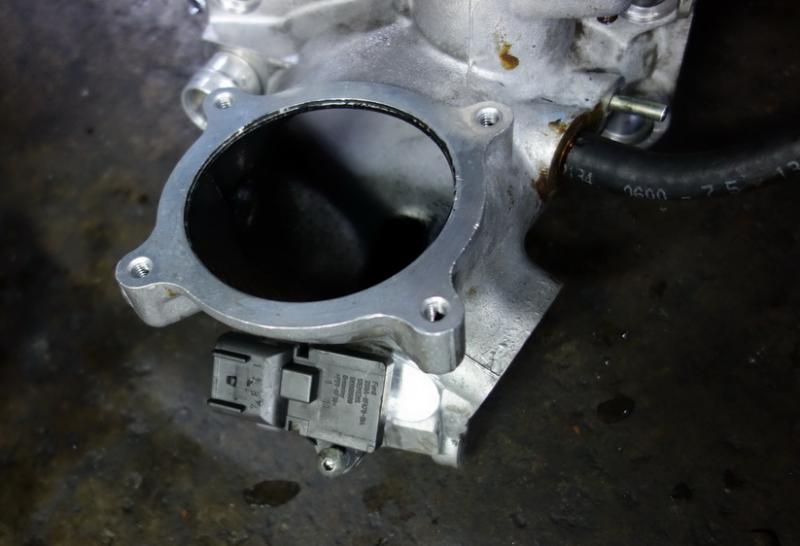

Hi, can anyone tell me what Ford car does this manifold pressure sensor for my 2005 XJR come from? This attaches to the elbow connecting the supercharger to the throttle body and broke apart when my mechanic was doing a supercharger replacement for me.
Also, can anyone confirm if the Beck/Arnley 158-1004 Manifold Absolute Pressure Sensor or the Standard Motor Products AS380 MAP Sensor Manifold Absolute Barometric pressure sensors sold on e-bay suitable replacements? Thanks for your help.

Cross reference that ford part number, guarantee you can find one alot cheaper. My MAFS (denso) was replaced with a Toyota part, my fuel pressure regulator is from Lincoln.

Sensor is just for the Jags but the XF, XJ and S type supercharged 4.2 share the same sensor part number AJ85329 which changes to a AJ812337.

Thanks. That's what my mech is trying to do, but we don't have a big following in Ford's over here as well, but certainly more than XJR's, so I'm trying to see if anyone knows which vehicle it comes off from.
Thanks. At least now I know what is the Jaguar part number for this as I don't have the component parts list for the engine. Interesting that it's not a C2C prefixed number.

ok same sensor will fit Mazda,jaguar,ford,and volvo-
here ya go:
jaguar-
JAGUAR (S-TYPE Saloon )(CCX)199901 -( JAGUARXJ) Saloon (X350, X358)200305 -( JAGUAR XF) Saloon 200803 -
VOLVO-(S40 II Saloon) (MS)200401 - (VOLVO V50 Estate) (MW)200404 - VOLVO C30200610
FORD FIESTA V 200111 (FORD FUSION ) 200208 - (FORD STREET) KA200305 - 200507 -(FORD FOCUS C-MAX) 200310 -(FORD FOCUS II) (DA_)200411 ( FORD FOCUS II Station Wagon) (DAW_)200411( FORD FOCUS II Saloon) (DA_)200504 -(FORD FOCUS II Convertible)200610 -FORD C-MAX200702 -(FORD FIESTA Van)200310 -FORD FIESTA VI200810
MAZDA (DEMIO) (DY)200304
HOPE THIS HELPS...

good find 912guy! I had hoped there would be more crossover for this particular part.

Thanks for the information 912guy. Looks like it may be a fairly common part and shouldn't be too expensive to replace.

How about for an x-type 2006?

I can tell you this, I replaced a broken map sensor on my xk8 with one from an 09 XF, and got another spare from an 06 xtype...all the same part, however, I was unsuccessful in finding a crossover on this part to anything else except a land rover.
