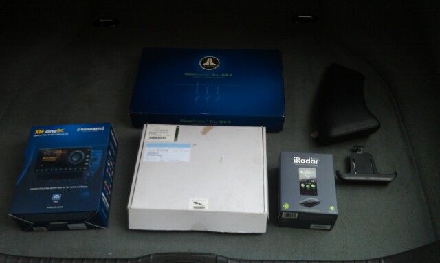

I installed the following components:

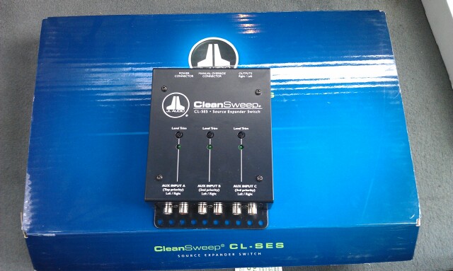

I have the Jaguar ACM, a Sirius XM radio, the Cobra iRadar, a phone base, and a powered phone mount. The last item is a JL audio 3-channel switcher.
I want to use both the XM radio and Pandora from my phone. I also use Audiogalaxy and stream music from my home server. I didn't want to have to switch cables and this one is automatic. It senses when an attached device is turned on and plays the one with the highest priority. I only have two sources at the present time so this leaves me room to expand.

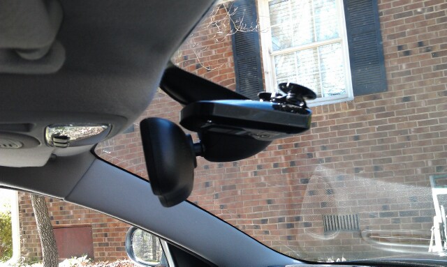

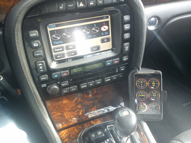

I borrowed my daughter's phone to get a few shots of the finished installation. I had to warm the suction cups on the radar mount with a heat gun to get them to stick.
From this angle it's noticable, but from any other you really don't see it. You don't see it at all from the driver's seat, since it's behind the mirror.

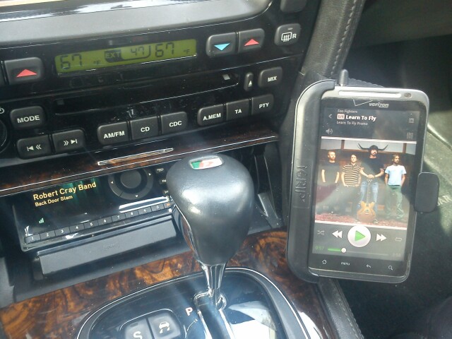

Here's the phone in the iGrip mount. After driving the car last night I decided to change the priority of the devices and make the phone number one instead of the XM. With the phone behind the XM I had to turn the XM off for the phone to play, and the power button on this receiver is near the top of the unit, where I can barely reach it in the ashtray. With the phone being first priority I just insert the 1/8 plug into the top of the phone and it switches to that input. Since the satellite radio is more or less permanent while the phone gets in and out of the car with me this is much easier.

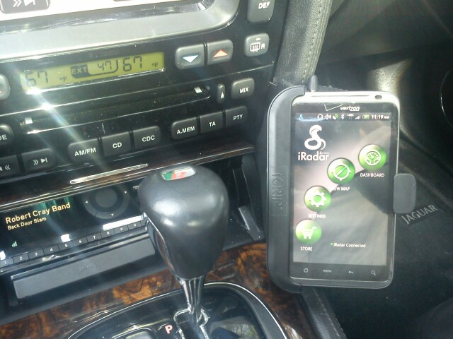

I haven't used this radar detector much, but it seems to be pretty cool. Without the phone link it's a basic radar detector that both beeps and gives voice announcements. What I do not like is that every time it powers on it announces: "Testing... System ready." That's going to get old quickly.
With the phone link it outsources all the bells and whistles to the Droid (or iPhone.) It has a database of speed cameras, red light cameras, etc and will put them on a map or just alert you when you approach. You can mark known false alarm locations so it won't report them every time. You can also report a radar location and it supposedly updates everyones iRadar for a specified period of time - a kind of high-tech CB call: "Hey y'all, there's a Smokey at exit 23!"

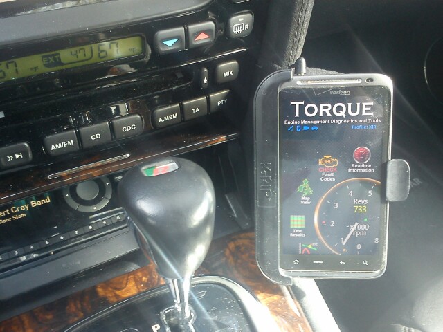

I also have a bluetooth OBDII connector so I can use Torque. Anyone else use this? I'm curious to know if your readings are similar to mine for HP and vacuum. It doesn't seem to read boost through the OBD connection.
