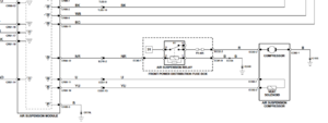

Paul,
If you compressor isn't running and you have replaced the compressor and relay, then the next logical steps would be:
1. Check fuse F6.
2. Make sure you have a good connection from your compressor to ground. Make sure pin one of your air suspension relay socket goes to ground as well.
3. Connect 12 volts to pin 5 of your air suspension relay socket to see if your compressor turns on.
