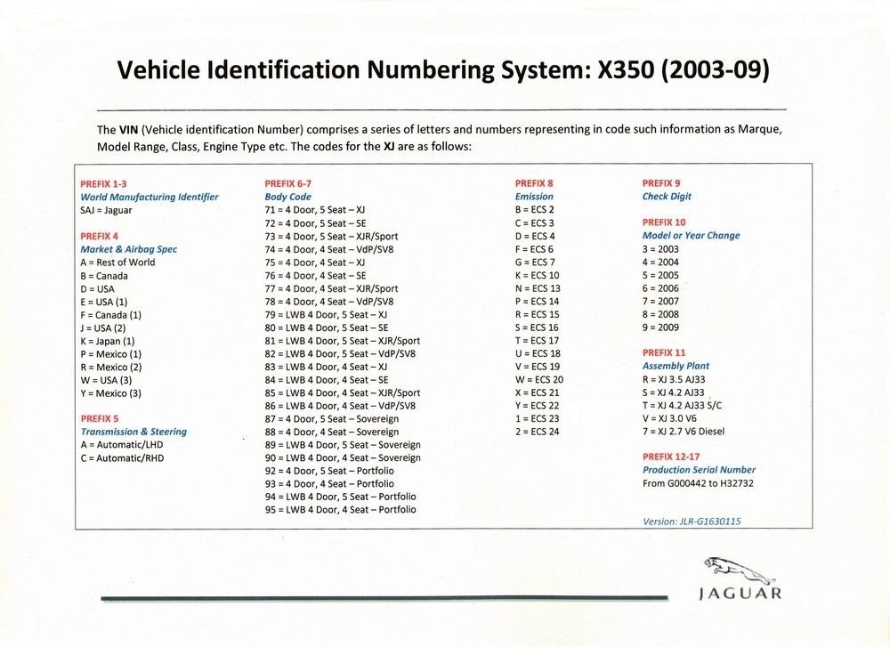

The x350 cars were initially SWB in 2003, but from 2005 on, both SWB and LWB were manufactured. Generally most x350 Super V8s and VDPs for the US market were LWB. The XJR was obviously SWB. In other markets SWB and LWB cars were marketed for most trim and engine specifications. For European and Asian markets, the SWB Super V8 was indeed produced.
The only real answer is to look at a car's VIN number and decode it. That specifies the market country, wheelbase, engine and trim level.

In the US yes, all Super V8 cars are LWB. If its supercharged and not LWB its an XJR.
Never knew you could get a Super in SWB as @Pete M said but I guess anythings possible in other markets. I thought by definition the Super was a LWB XJR for the most part.

Here is the VIN table, see what it really is.
NB there is a typo on the table. Digits 6&7, 74= 4 door, 5 seat.
Typo: 74= 4 door 5 seat
Pete M
