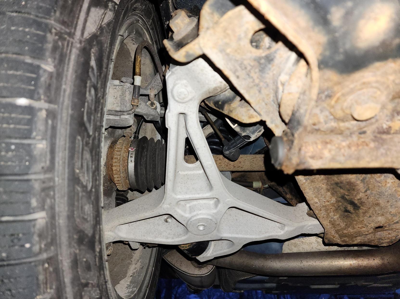

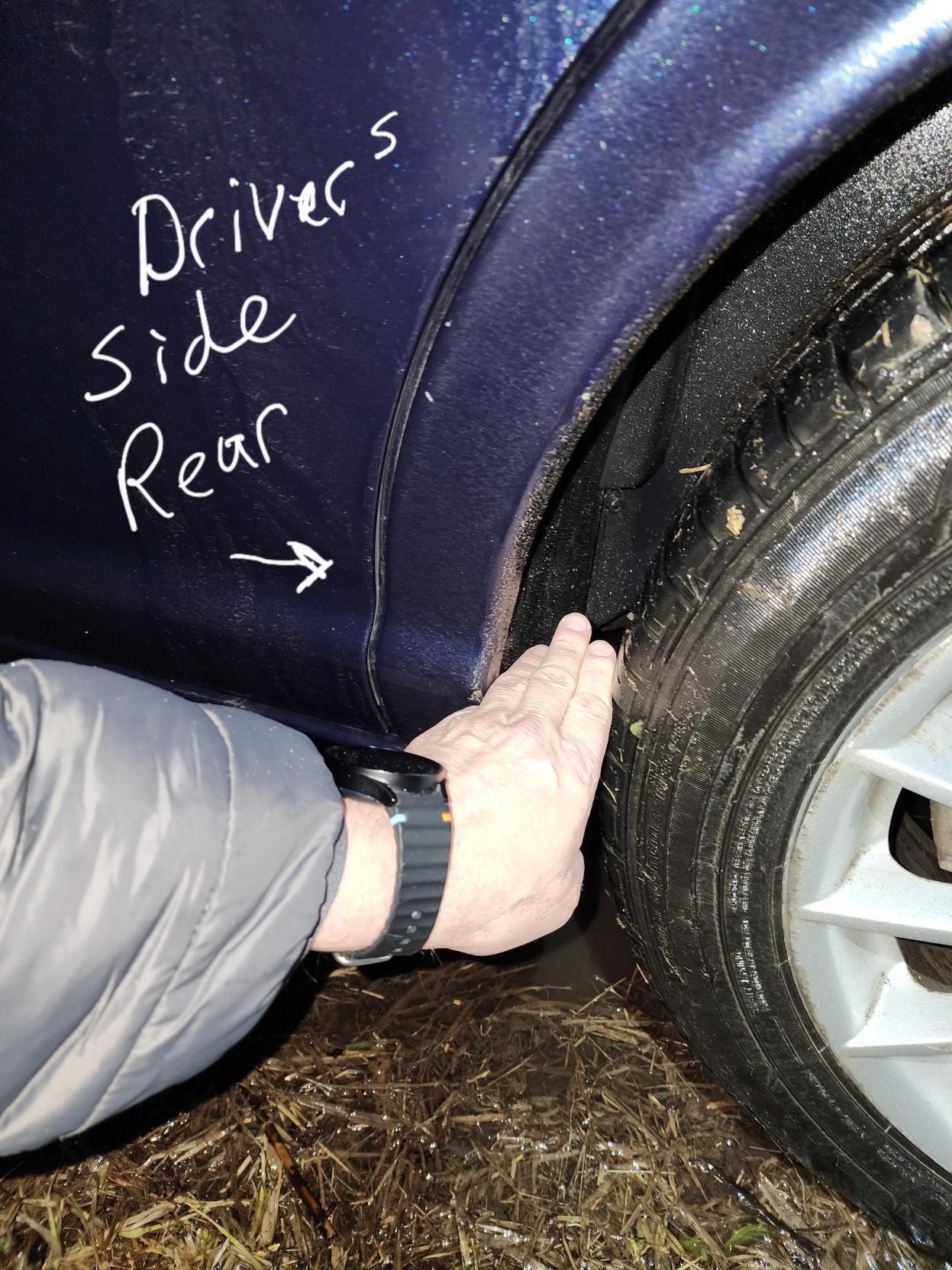

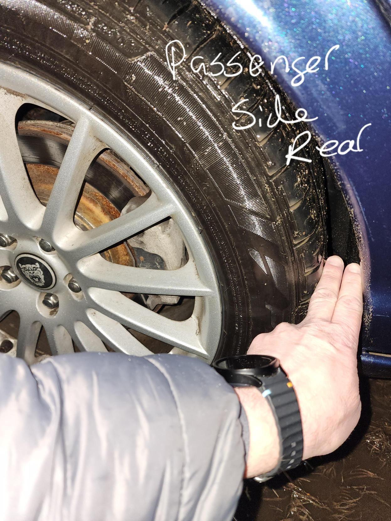

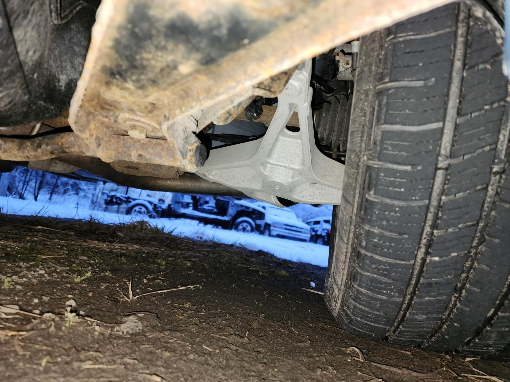

Thanks for all the suggestions, I was away from the car for a bit, and wasn't checking the forum. I am getting up on a lift next week - hope to know more then. But I did get a few other images to add to the confusion. Since I can't easily show the distance of the wheel base, these images show that I can get 3 fingers between the rear wheel and fender on the driver's side BUT only two fingers on the passenger side. I found an 05 jag and discovered both rear wheels I can get only two fingers between the wheel and fender - So it seems it's my drivers side that is off by 1 finger width or approx.3/4 of an inch

Did shop do wheel alignment after CA change? Have shop tightened bushing bolts when suspension was loaded with car weight? Sorry, may seems stupid questions nevertheless...
I did mine CA at rear both top and bottom about month ago. Can concur both of my rear wheels are 2 fingers away from edge of fenders. measured as you did.
