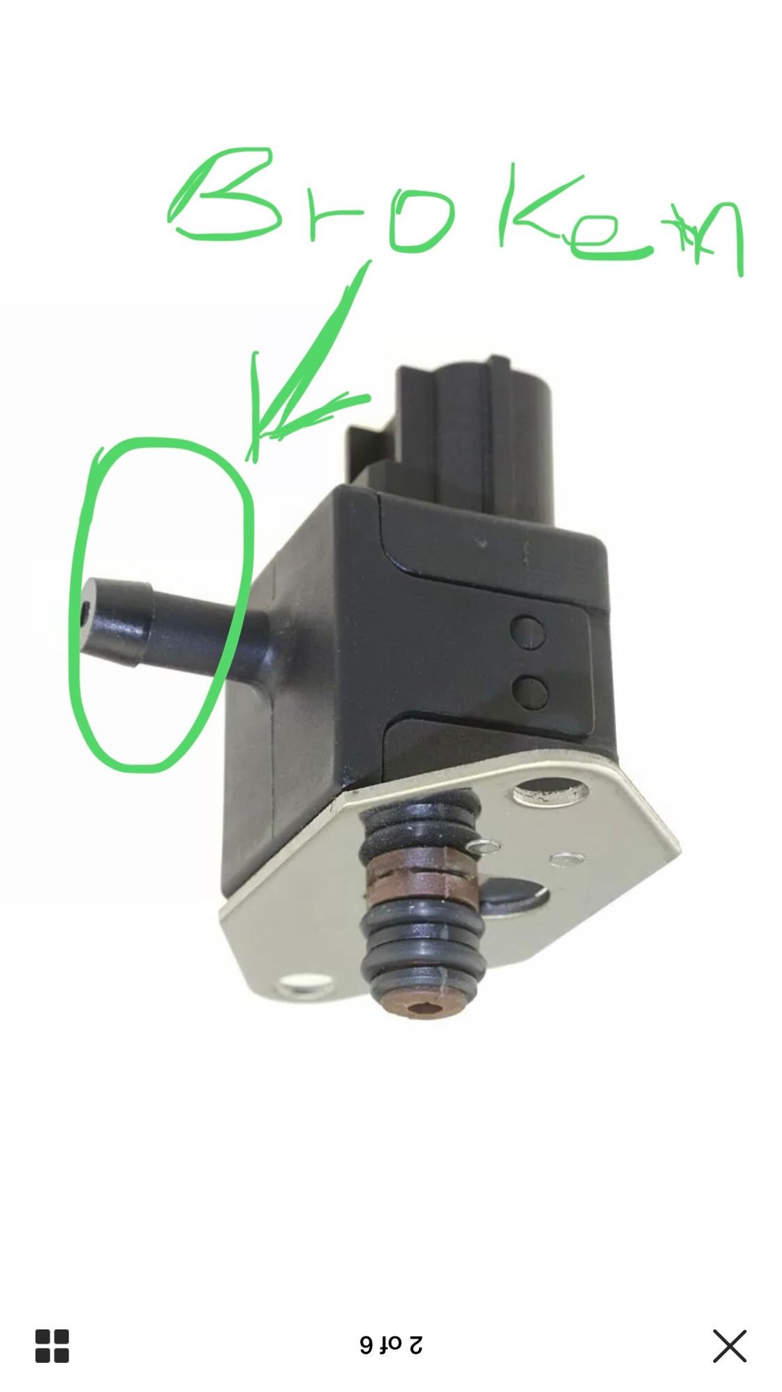

Watch my video ,, I found a vacuum leak , it is a broken hose that comes out from the back of the throttle body and goes to the base of a connector on the injector rail .
I need the name of that part , any idea?
Old Aug 31, 2019 | 01:22 PM
rf69's Avatar
Posts: 349
Likes: 12
From: FL

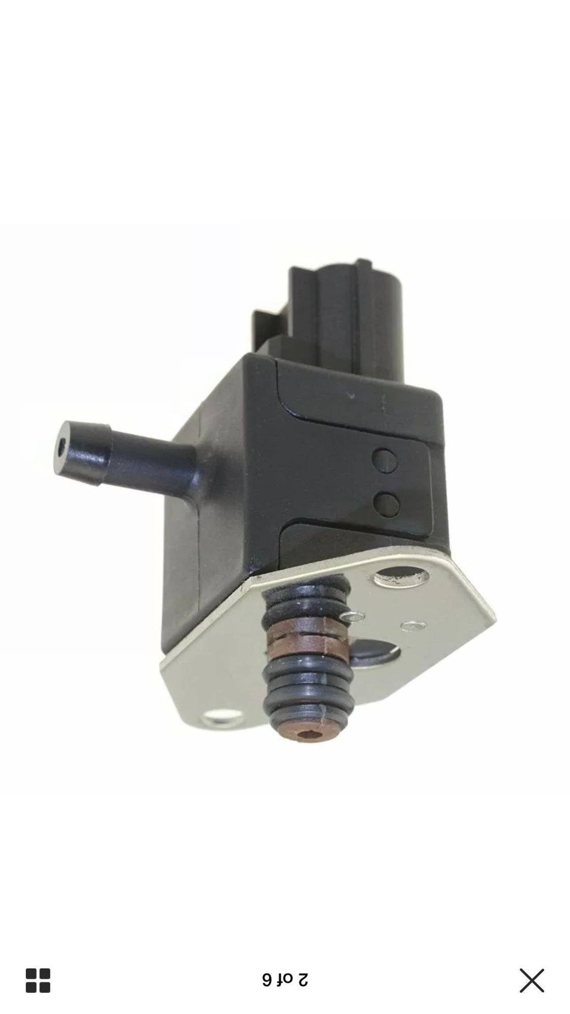

The vacuum leak was a broken thin hose that comes from the back of the throttle body and connects to the Fuel injection pressure regulator sensor.
the hose broke at the base where it connects to the sensor located on the fuel injectors rail.

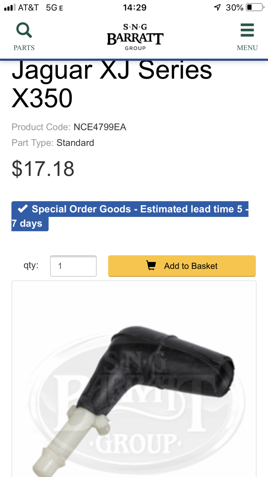

I got it from Barrett
The vacuum leak was a broken thin hose that comes from the back of the throttle body and connects to the Fuel injection pressure regulator sensor. And a Vacuum elbow that attaches to the sensor.
The hose broke at the base where it connects to the sensor located on the fuel injectors rail.
