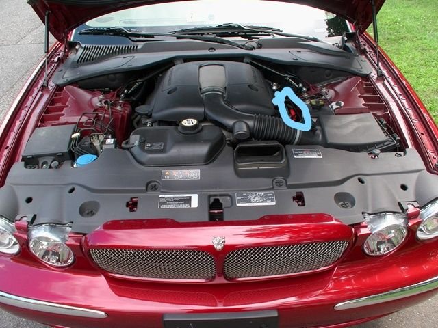

Hi fellas,
I wonder if anyone knows common coolant hose leaks on the 2004 XJR? After driving my car, I noticed smoke coming out from the driver side headlamp, when I opened the hood and the smoke came from the side of the engine....it's only smoking for a few seconds and then done...I tried to let the engine run but no more smoke.....when I point my flashlight in between the engine the shell(?) I don't see any sign of wetness nor any fluid dripping to the bottom. It smells like coolant but i could be wrong...the smoke is like boiling water smoke..so I know it's not oil related which I assume coolant. {confused}
Where should I start looking?
NOTE: this is not my car's pic...just copy and paste from google to point out where the smoke coming from.

See if there is any coolant stain on any of the rubber hoses in that area or on any surface in that area.
If there is a pin hole pressure leak it can be difficult to see. I have used a powerful flashlight to find such a leak at the front of my engine with it running.
I got as much out of the way as possible during my search while still allowing the engine to run.
Where you mark that area on your picture there are no coolant hoses. The valley hose under the SC usually leaks out the back of the engine area.
The pipes up front by the radiator could have a pin hole leak spraying back over the exhaust manifold.

OK, thank you...could I have an exhaust manifold leaks instead? if I do how do I confirm that? any ideas?
I will check for the coolant hoses...might be time to replace some of them

Possible yes. However you did state that you could smell coolant but that might be unrelated?
Yeah, when you said there's no coolant hoses near there...it got me thinking.
