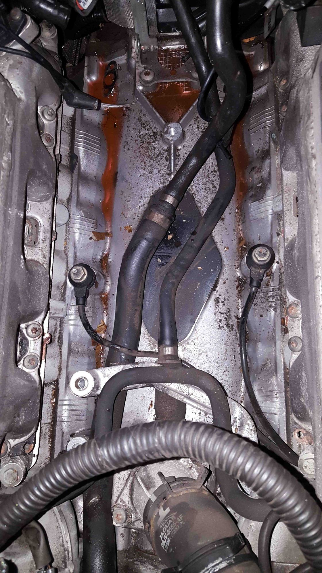

OK, I will try again, tried to post a reply earlier with attached pics, but it seems to have gone AWOL, think maybe the pics were too large.
So I ordered up a list of parts, Including the 2 Knock sensors, probably won't get them til after Christmas now, But I am still having trouble Identifying and getting part numbers for one hose in particular, the second hose that runs the length of the Valley, and would Ideally like the number of the U-shaped hose in the second pic as I think it would be a lot easier to replace this hose at this time too. Here goes......

If you haven't done so already, use tape or rags to cover the inlet ports to the heads until you're ready to reinstall the supercharger.
The EGR feed hoses carry JLR part numbers of AJ811761 and AJ811758 respectively.

Yeah thanks, stuffed the ports with rags, after the pics, I left all hoses pretty much in situ until i get the replacements to aid in remembering where and how they go.
