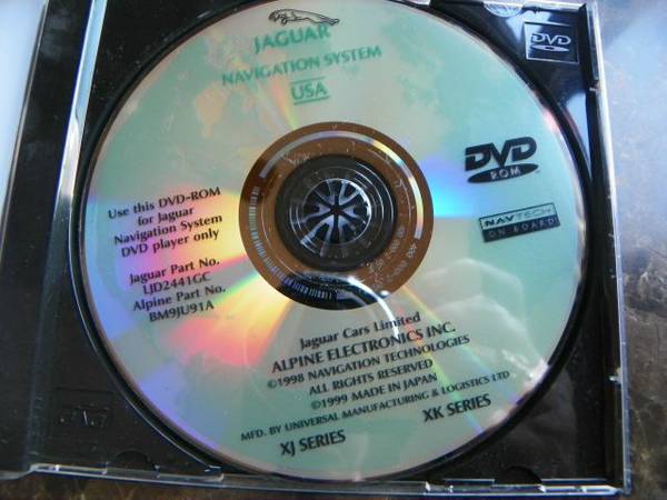

Nav disk for sale:
2007 JAGUAR XK NAVAGATION DISK

Originally Posted by reyesl
XK discs don't work with the X350

The disk indicates for XJ and XK.

Wrong XJ, that's for an X308 with the Alpine Nav, X350's have the Denso system.
Thanks for the correction, didn't notice that. I checked both of my disks and they do indicate DENSO...
