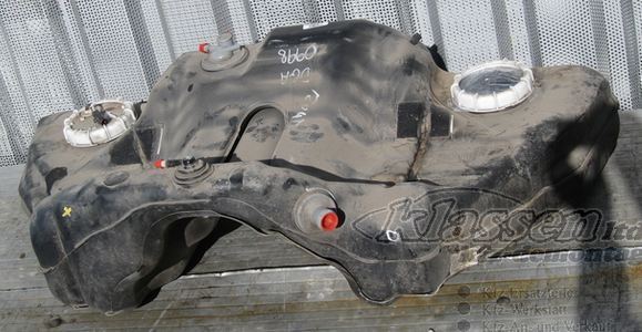

1.Is there any after-market equipment on the car (not that there IS much in after market for our X350) I am thinking anything that required drilling or self tapping screws in the body work such as auxiliary amplifiers etc. Note that the fuel tank on these vehicles is formed to fit the body cavity under the rear seat and is right against the aluminum body panels - I would get the rear seat out pronto and just confirm that there is no breach, either from someones screw up or simply a loose mount at the fuel tank where the lines, fuel pump and float mount.
Jaguar X350 Fuel Tank
2, It may be worth replacing the fuel filter - even at your low mileage. If someone bought contaminated gas with rust or particles in it, the fuel filter is limited in what it can hold and continue flow - Its an easy replacement, remove plastic panel under left side of car, unbolt the brace on the filer, and the two lines - also loosen the plastic line mounting clips (1/4 turn screws) to give you room to pull the lines out of the filter. You will spill a few ounces of fuel, not a lot, but have something to catch it. Install new, no O-rings needed, and torque to spec. 20-25 minute job at most. A clogged fuel filter will cause excess pressure BEHIND the filter (at the back of the car) and put a strain on all the tank seals back there. Mostly at high pressures of WOT. Seems a logical place to start. When I did my filter (at 88k) the thing was so clogged you could barely move air through it, nevermind liquid. This is such an easy thing to do and inexpensive, there no reason NOT to eliminate it as a cause. Heres a thread with a DIY on these forums:
