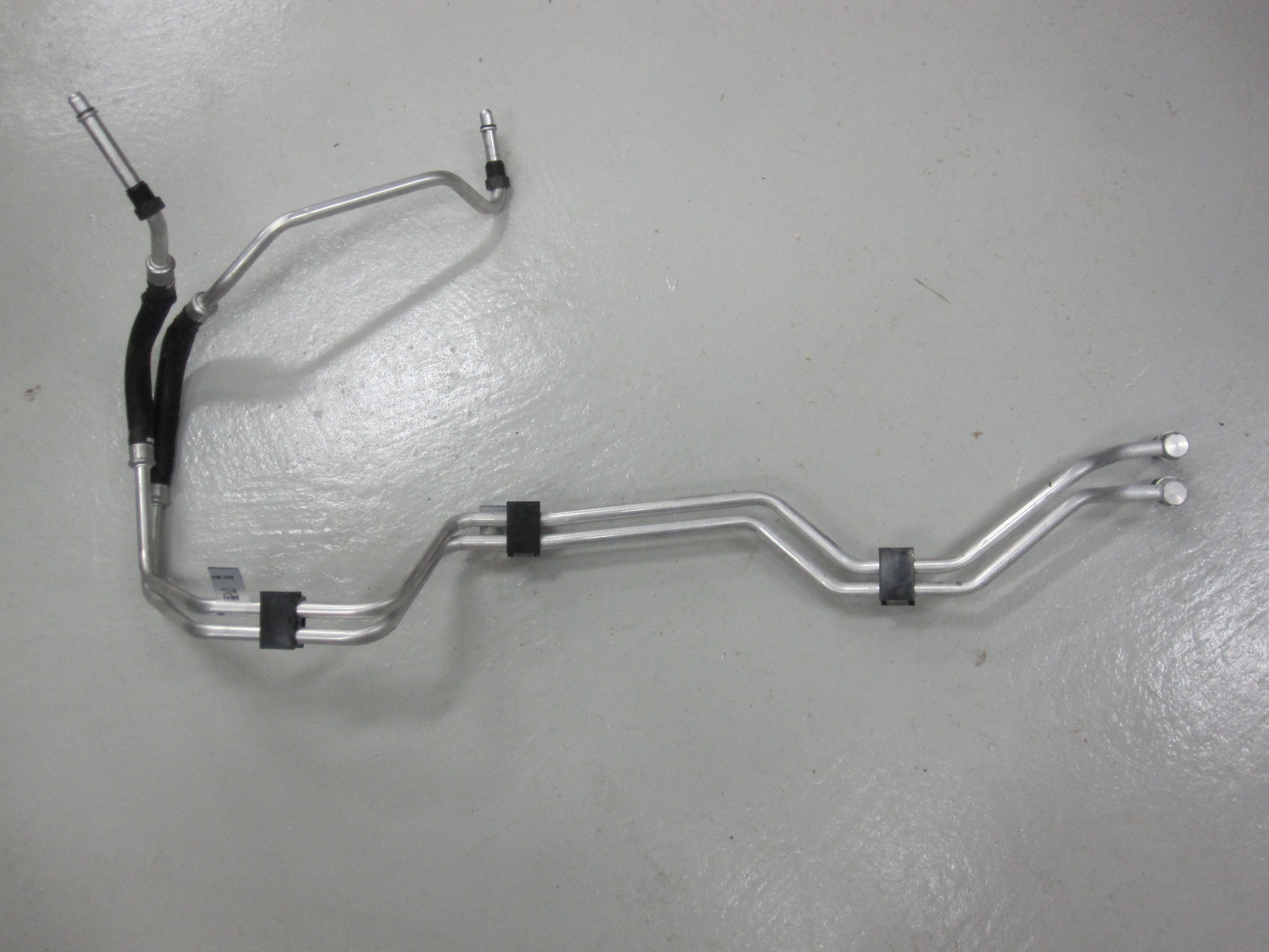

Do these lines come in pairs? I don't think I'm going to be able to get these in time before I go on vacation and was wondering if anyone has had luck brazing the ends where the tubes go in ? Another option is to cut the lines flare the ends and use some high pressure hose and crimp clamp. Just some thoughts
Old Dec 11, 2014 | 10:05 PM
abonano's Avatar
Joined: Mar 2012
Posts: 4,759
Likes: 1,435
From: Hazlet Township, NJ
Yes, the cooling lines come as a pair. I have heard of others cutting the lines off and using high pressure rubber hose with double hose clamps on each end (only one of the lines has high pressure) but well within the tolerance of the high pressure rubber hose/clamps.
Hope this helps.
Old Dec 11, 2014 | 10:21 PM
XxSlowpokexX's Avatar
Posts: 1,245
Likes: 174
From: NYC
Thanks. My low pressure line is leaking. Its a very small drip. maybe Il give it a try till I get back. :O)
