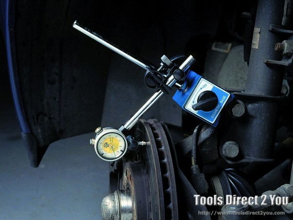

Can you feel pulsing of the pedal when braking? That is a symptom of warped discs,it may be that warped discs on the rear are not so obvious.You may not see warping just by looking at the disc.
The image shows how to measure run out.
I would jack up each wheel in turn and spin it by hand and listen for bearing noise.
The other possibility to my mind is CV joints on the rear drive shaft but you do not have many miles on your Jag.
