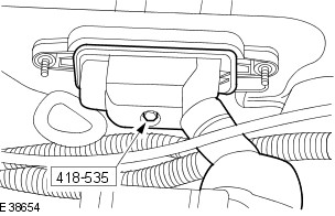

On my 2004 XJ8 the engine wire harness is attached to the firewall with a single bolt which appears to have a security torx head. I have a set of torx security sockets up to T40 but none of them will fit. Anybody know what fits this bolt?

I assume you're referring to this connector which is for the ECM - it uses a 5 point security torx, not 6 point.

To add the size is 30

Tamper Proof Torx Plus
