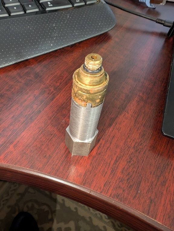

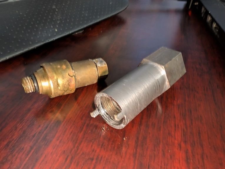

Reporting some progress:
1. That tool I purchased on AMAZON:
Amazon Amazon
OD is too large; teeth are too big. Good thing I did not buy it on US side it was 3x more expensive. Oh, well, live and learn!
I just grabbed hex bar stock of free machining steel in machine shop and made one. It took me about 30 min turn and mill it and then coming back to turn OD down 0.25mm.
Commuting from home to work 2x times took more time than making it!
Any way I am attaching drawing for this wrench if someone wants to make one themselves
Here are pictures of this tool:
Naturally, I jacked up the wheel I was working on to reduce forces on air shock.

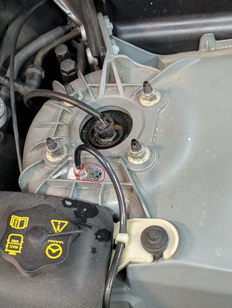

After cutting down 'used' portion of air tube approximately 6-8mm lubricating O-rings and threads with lithium grease and installing new valve. I did following: I used similar sized pneumatic tube, connected one end to valve, and and shoved compressors airblow nozzle into another end and held it together for about 5 minutes. The only leak I heard was leak in quick disconnect.
Disconnected rigged line.
connected line from car, lowered jack to approximately correct height. Car was still supported by jack.
Started car let run for a while. air compressor is very quiet and changes in coming from worming up engine muffled compressor noise.
Any way three minutes later I decided to test my luck and lowered jack completely.
Car did not sag a bit!
wheel arch apex to center of the wheel 'measured' with tape ~380mm one side ~390mm the other side.
No bubble at the valve!
Took car out for a short ride; came back measured height again, everything as it was!
Car is playing garage queen in winter months so I will see and report in two weeks.
So far it is looking good!
Thanks everyone for suggestions and moral help.
