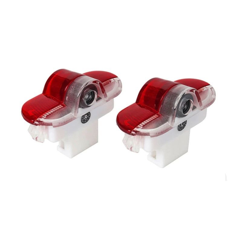

Default XJ Jaguar Logo Lights
This is the purchase logo lights.

I'll hazard a guess and say that if you squeeze the two retainer clips on the white plugs going into your current light assemblies, the plugs should come out easily.
Then you might find that the white plug actually contains two 'sockets' (the light fitting probably has pins embedded in it) which might allow you be able to gently insert the pins of your new light into those two sockets.
Depending on whether your new lights are LED or filament bulbs, you might find that the two wires might have to be inserted in a specific orientation for correct voltage polarity.
(LED lights will only work with correct voltage polarity, whereas filament bulbs don't care what way around they go).
Once you have that sorted, then you will want to secure the wires and pins into the plug so they can't fall out or have any exposed metal that could short to bodywork. So some insulation tape will probably cover that task for you.

I agree with the above, the white connector needs to be unplugged from the original light.
There may be an adapter cable needed, I'm not sure but one is shown here
2X New Logo LED Door Courtesy Laser Puddle Lights For Jaguar XK XJ X-Type S-Type | eBay
Polarity is uncertain (which wire is which), but since there's no color code just try either way.

Squeeze those tabs that stick up. Those are retaining clips for the connector. Squeeze those and it should slide right out. You'll probably find that you can just stick the metal pins from your lights into the connector. If the light doesn't come on, swap them with each other, because one will be ground, the other will be 12 volts. With an ordinary bulb it doesn't matter, but with an LED the polarity is important.

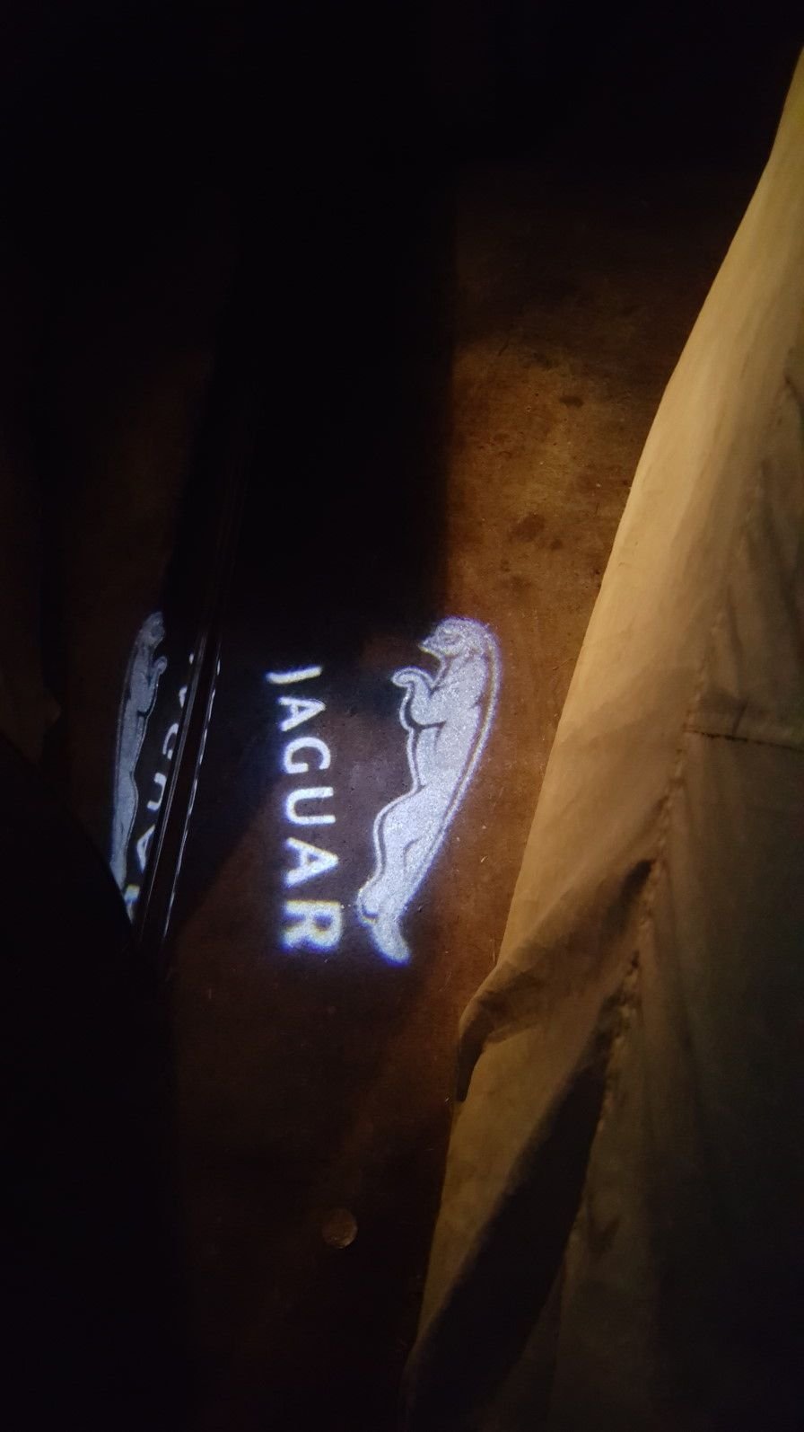

My projector lamps didn't fit . The body is about 1/8" longer than the original puddle lamps but otherwise the same.
Embrace Aliexpress, just not "A-YYUU Store".
I could project a Leaper on the neighbour's house. He drives a VW.
Edit: Forget that, I got them in eventually albeit tight. Since they looked identical to Pete M's post, I just tried harder.
