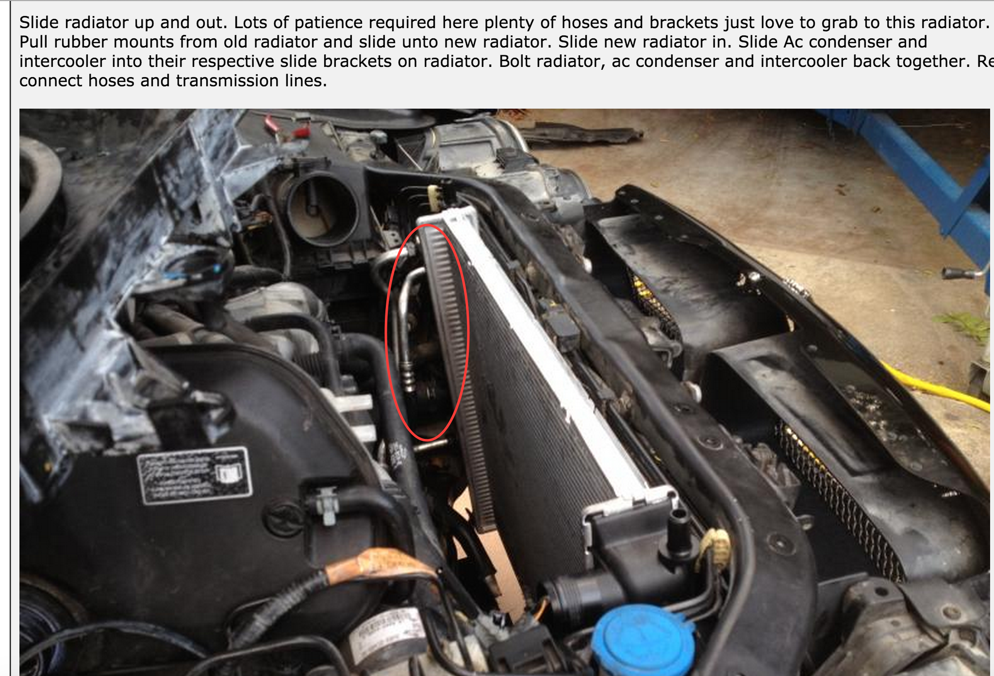

Originally Posted by slmskrs
Thanks for the write up and link (and info on purchase options). I'm surprised at all of the bolts; the Expedtion had two. I don't have an R so no intercooler. Will that make it easier to access bolts, etc.?
It will be slightly easier without the intercooler. All in all not a too hard job. Btw, mine went out at the same mileage too.
Hey BlackKat,
I'm going to start a new thread called, "HELP!! I can't get my radiator out". When I look at your picture below, it appears that the "pipes/tubes that go to your AC condenser have much more clearance than mine (maybe because of your intercooler). The clearance in the oval between your radiator and the AC pipe is big enough that I can see how you can get the lower hose bib through that clearance.
Looks like a crack in the radiator plastic header-screen-shot-2015-07-30-9.53.02-pm.png
I'll post pictures of mine in the other thread, but there is no physical way there's enough clearance to pull the radiator up through the U shaped AC tubes to pull it out. 10pm and I'm stuck. There's got to be a trick, but I sure don't see it..... I hate working on cars to fix them; I like working on them to improve them......Gonna have to borrow my daughter's Rav4 to go to work tomorrow....
