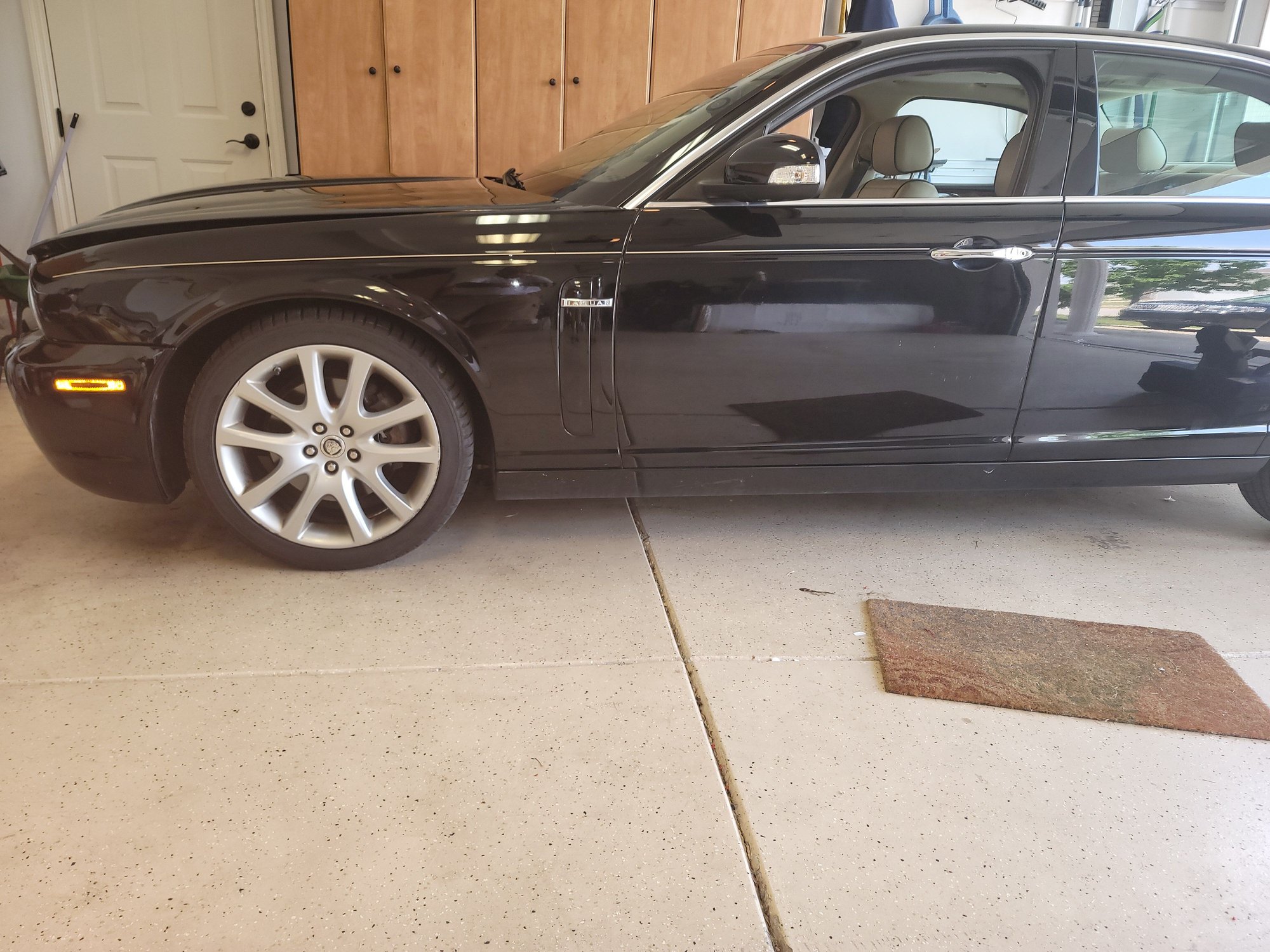

Hello
I have no error codes or suspension with icarsoft reader. Yet I feel that my car's front is lower than the rear as you see in the picture. Is this normal?

Seems to be to low, is it similar on the other side?

Yes; both front sides are the same.

Too low, should be 2-3 fingers above the tyre or like the rear.
It looks like an "overnight let-down", normally pumps up on unlock, or when the engine starts and the compressor runs.
My own car does that, sometimes, and only the front or often so.
