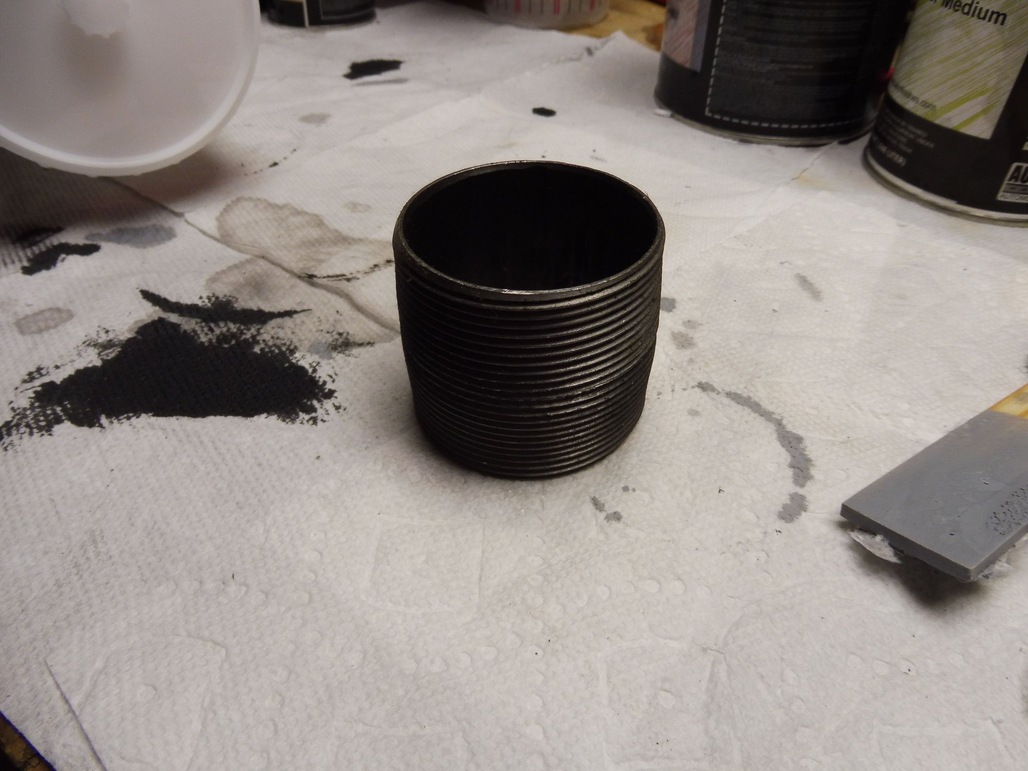

I bought a pipe connector of the correct size at Home Depot to use to push in the bushing with a 10 ton press.
I also "flattened" the sharp rim of the pipe connector.
