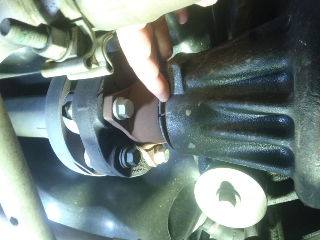

The noise is still around, I think I have it narrowed down to the left front. I lifted the back end up and had the wheels spinning at 60 mph with no noise.
I'm not having any other symptoms of a wheel bearing going out but I think I will look in to it.
Old Feb 15, 2013 | 01:07 PM
03Xtype's Avatar
Joined: Jan 2011
Posts: 386
Likes: 32
From: Indio CA

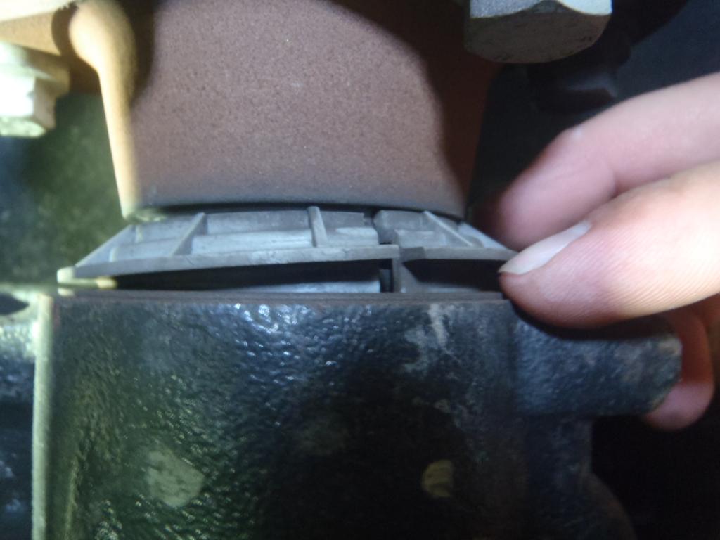

I was finally able to simulate the noise by running the vehicle with the wheels off the ground.
Here is the cause of the noise. It is amazing how loud and deceiving a rattling piece of plastic can be.
Attached Thumbnails Noise starts at exactly at 36-37 mph-p2120162_zps0fe2c20c.jpg   Noise starts at exactly at 36-37 mph-p2120163_zps0663235f.jpg
