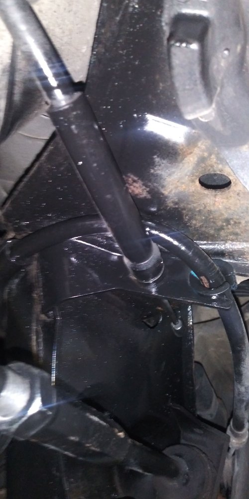

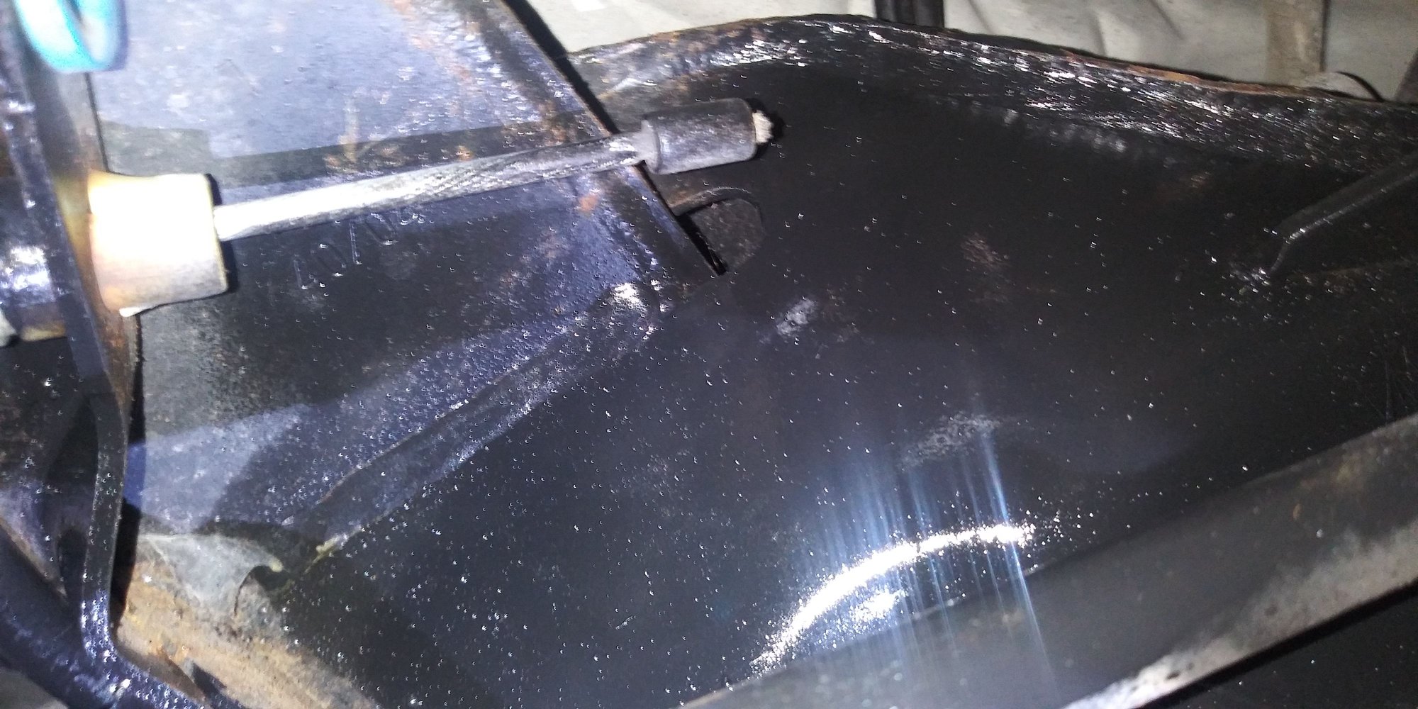

Both cable side by side
Cable end opposite end of cable that connects to caliper hooked to nothing
Here are two pictures the first one is the end of the cable away from the caliper the second one shows the other cable alongside of it going to the right side

Default Pic
I have cables on both sides they are both connected to the levers on each of the calipers my problem is the other end of the cable witch hooks onto nothing the one on the passenger side does go from the caliper all the way to the motor under the trunk

Ok now I understand.

Ok do you have Brembo brakes?
According to my workshop manual if you do not you only have the one handbrake caliper.

Default One caliper
Thank you I have just regular brakes I believe nothing is Fancy on this car I can hear the motor run when I pull up on the parking brake lever but it's not moving the cable down by the caliper. And I get the error message park brake malfunction any ideas that does not look like it's very easy to get to the motor if that's the problem

Looks like there is something wrong with either the motor or the cable connection to the motor.
It really does not look easy to get to I agree.

Yes it looks like the cables are not being pulled and therefore tightened to engage the parking brake.

Well it looks like I'm going to find out how hard it is to get that out I think there is something wrong in the motor assembly it's not moving the cable in or out even though it does run
