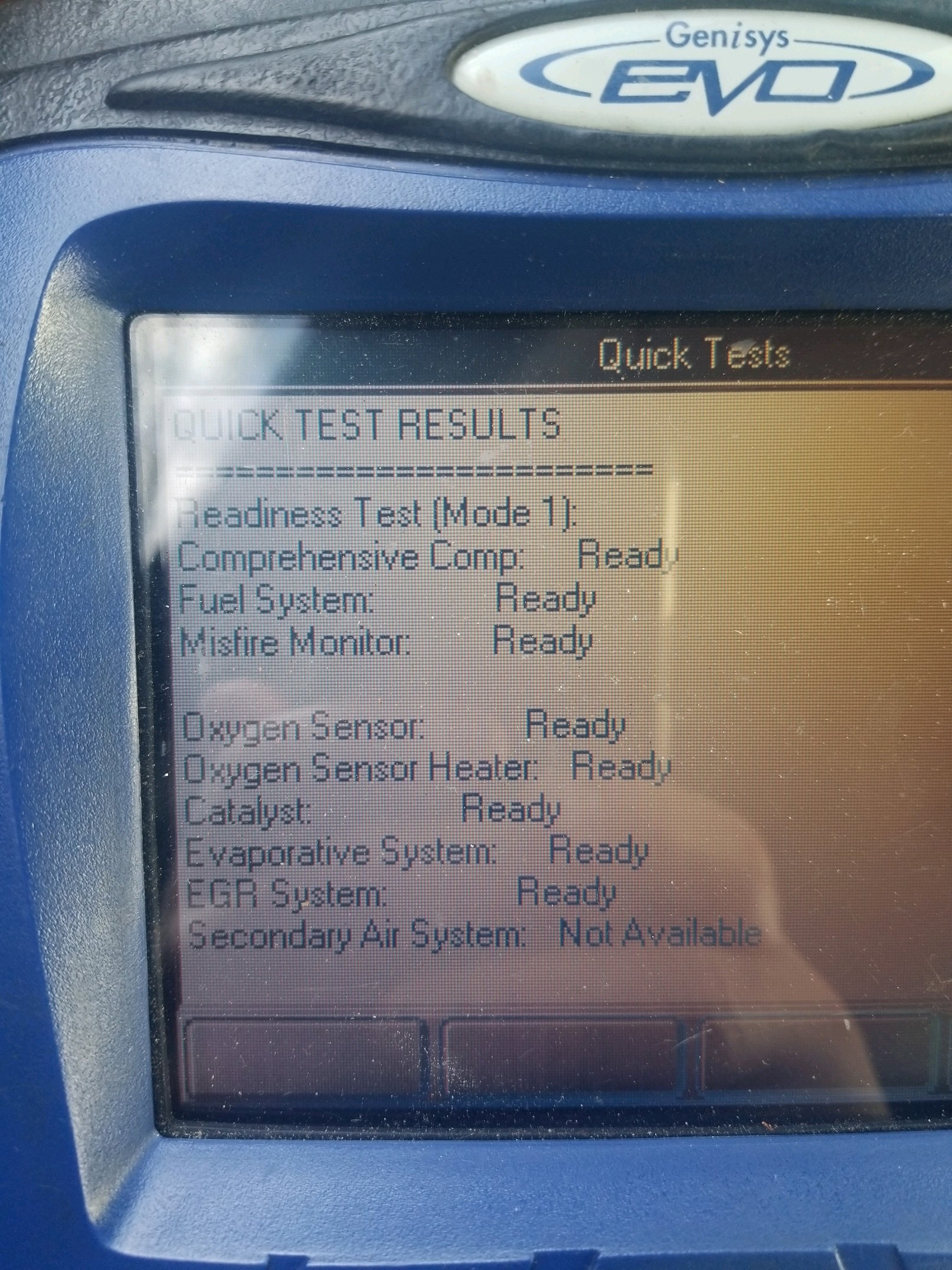

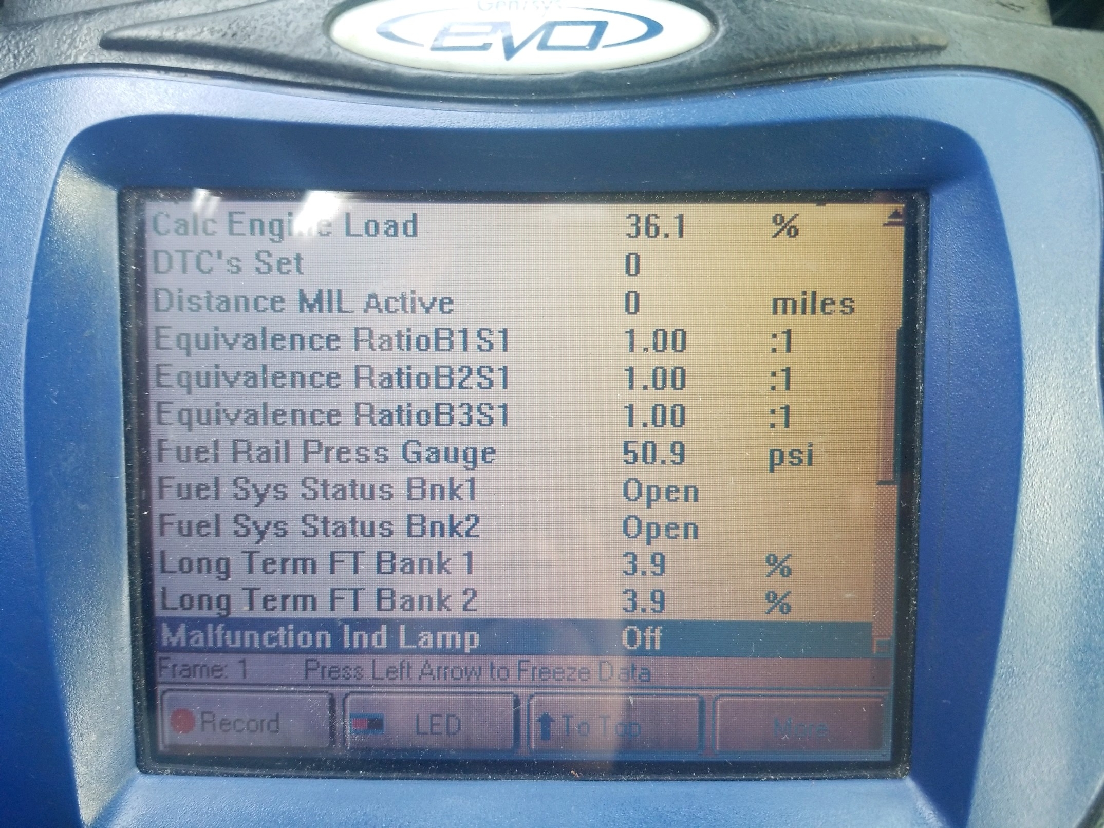

I took the car out for a drive.
LTFT's are now at 3.9% both banks.
Please note - metal throttle body gaskets are a one time use item. If you choose to reinstall as I did your rolling the dice.
In my case I came out with "snake eyes". Hoping this post helps others down the road.
Could not find a bolt torque value. Went with 10Nm (same spec as NA 4.2 throttle body bolt torque)
Attached pics are with key on/engine off...
Cheers!
