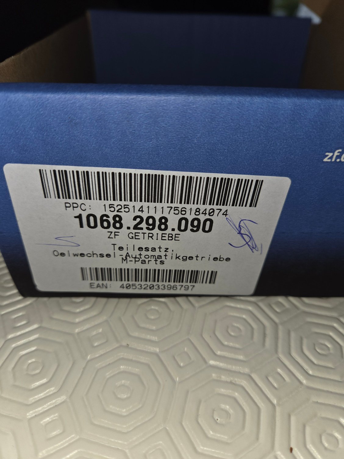

Had 2 oilchanges over 225k miles on xj8.
the normal oilchange kit from Zf has 7 liters new pan with magnets and filter. Wich is enough for normal oilchange. About 3 Liter will stay in the torque converter. I did it that way and it helped a lot on an 2003 xj6 3.0 with 90k( so 23 years old oil ) . Drove 2k miles on it then drained the fluid again just through the drain plug on the pan and filled up again with new oil zflifeguard 6 around 4 liters .
the other parts changed when the pan was off is the seal tubrs bridgeseal and connector sleeve for the electric plug .
Old Oct 5, 2025 | 04:13 AM
Petz's Avatar
Joined: Jan 2021
Posts: 615
Likes: 141
From: KEHLEN , LUXEMBOURG
Zf6hp 26 oilchange kit would be 1068.298.062
