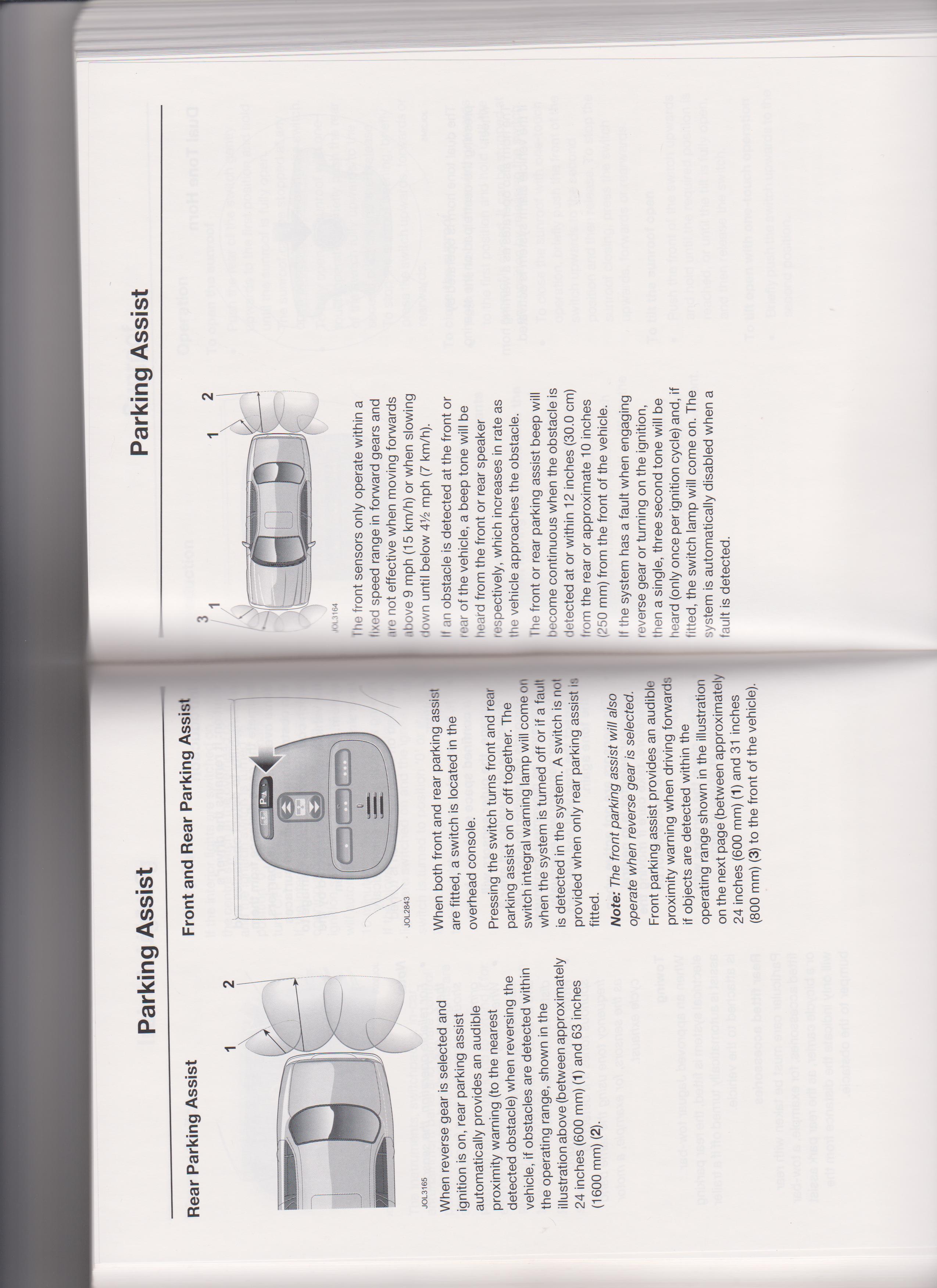

As I said in an earlier post you should have a button in the overhead console.

MY04 front park assist sensors were an option. If you only have rear sensors, there will not be a button on the overhead consul to silence the speaker which is located on the (rear) parcel shelf. If you prefer not disconnect the park assist control module (in the trunk near the spare) you could disconnect the speaker (covering the speaker wires as there is obviously a signal there when you shift in reverse) but this required back seat and parcel shelf removal.
Thanks for the info!
