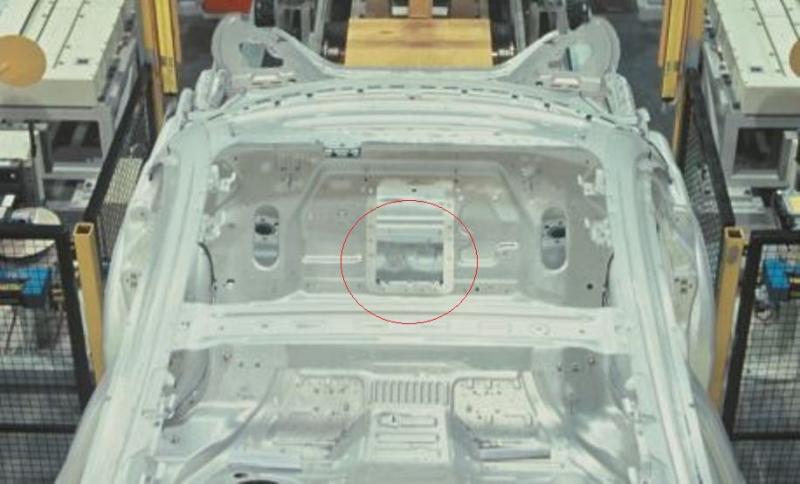

I just had a quick look in the parts manual and the only bits that seem to mention the ski hatch are:
C2C24443 - Trunk carpet with ski stowage
C2C14861 - Ski Hatch assembly
They are parts 1 and 10 in the attached picture.
You could cut a hole yourself in the carpet and David Manners in the UK list the hatch for £168. Not sure what else you would need, if anything.
It sounds like the hatch has a ski bag built in to it so as you poke the ski's through they extend the bag to stop the car interior getting dirty. You can probably get everything that you need fabricate elsewhere though.
I assume the hole in the second picture is where the ski hatch is located.

The hole is there on my car. It is covered up with a riveted cover. Simple enough to remove. The fold down armrest covers it.
