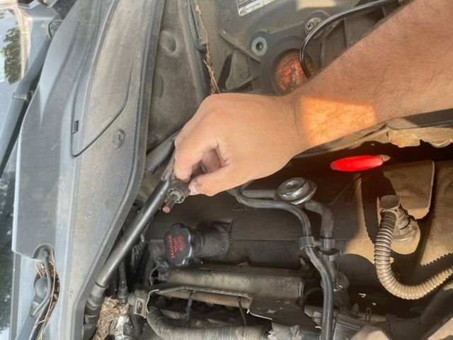

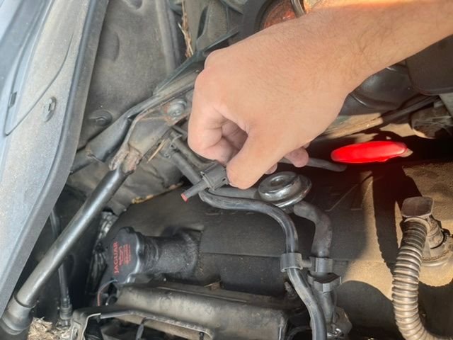

I did find this random unconnected plug.
would anyone happen to know where it connects to? I had my air suspension replaced with coil springs years ago. Not sure if related.

Ok, so your Restricted Performance is due to the P0171/74 codes (lean - bank 1 and 2) you have a vacuum leak common to both banks, which is probably somewhere in your air intake.
The plug you show goes into the top of the air strut to control CATS. Since you converted to coil overs just tuck it away somewhere in the engine compartment.
